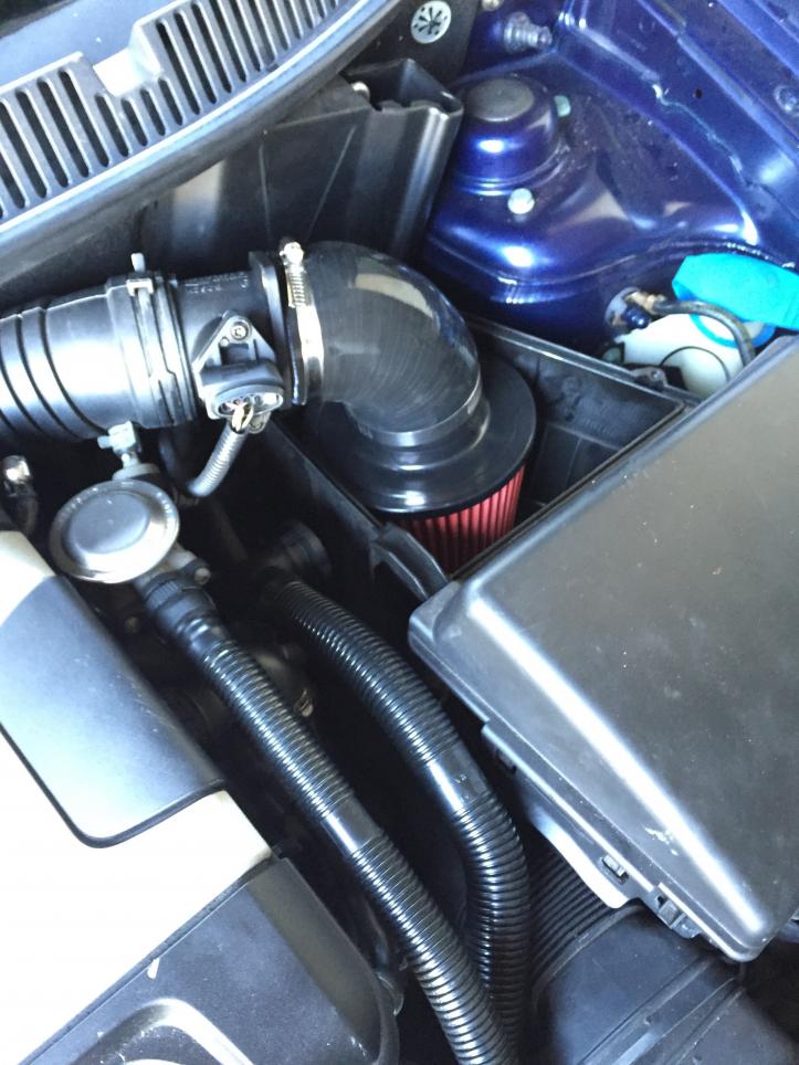

                      • after seeing Josh's steup i got a little excited and bought a pod and some parts need to trim the hose to make it fit right but looks like it will sit nice but having it bolted straight onto the afm kinda sounds like a wrx down low haha also picked up a new turbosmart boost gauge old one only went to 20psi but looks to go over a little so a 30psi one is going in

                          • Well I've put on the pod sound alright down low have that little bit of noise I'll have to make a cover at some point but haven't had time to install the TIP yet hopefully next weekend and I installed a new boost gauge a turbosmart one my old saas one made some weird rattling noise might of been faulty

                            • Did you get much turbo noise or just induction (honda like) sounds? Incidentally, what kind of pod did you use?
                              • u can fit the top of the airbox back on with a little bit of die grinding. I also cut a hole in the bottom half to let a little bit of air in.
