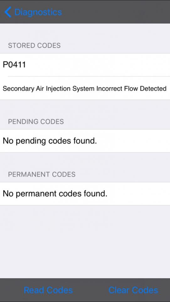

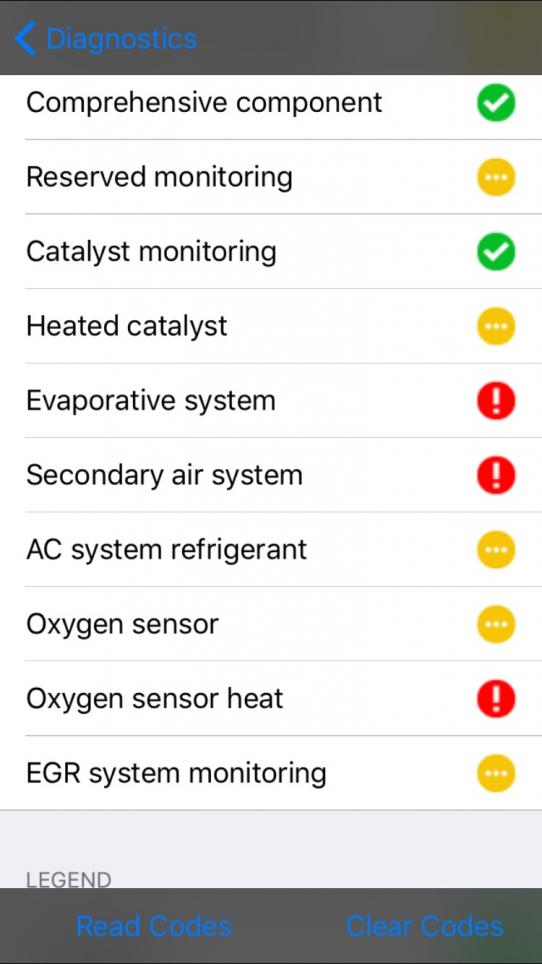

    Think I spoke too soon tho about the car good let work today got a street away and a warning light came on �� Haven't lost any power or anything but I'll get it scanned again tomorrow most likely something stupid the only thing that has changed is installing the pod but it's been running like that the last few weeks hopefully it's just something silly

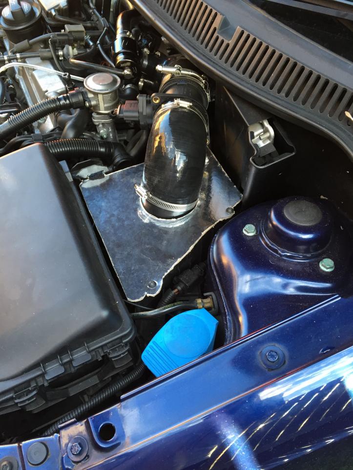

          Only problem was I was short one clamp so I had to put the standard air box back on but I'm not worried the pod can go back on in a few weeks
          • Had some time today and put the pod back on and made a temporary cover for the box nothing special but will do the job for now

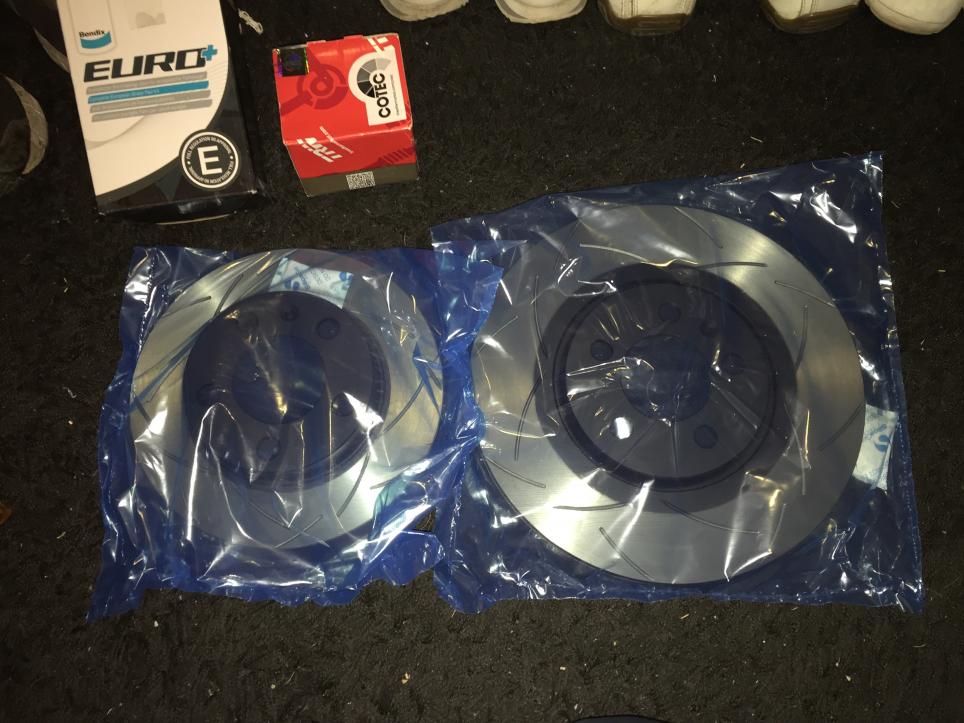

            • Well the time has come to do brakes cos my front disks are a little warped and rear pads are low so I've decided to just redo them all and ordered front and rear DBA slotted disk and some bendix euro pads for the front and some TRW for the rears that will be ready in a few days I'll post some pics when I put them on

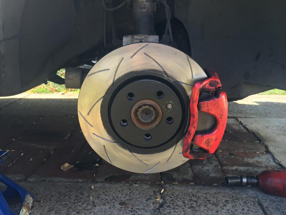

                • Front and rear discs and pads done today lucky I did them now looking at the rear pads they were almost on metal

                    • Didn't see the point of upgrading the rears just being my daily and a street car not something I'll ever track just some good discs and pads will do the job fine and they feel good

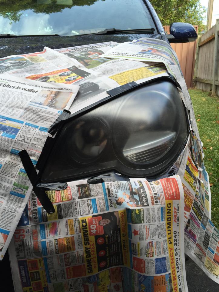

                      Today I gave my headlights a go to clean them up a little rubbed them back and hit them with some clear not the best and as clear as I would like but still a lot better than how they were and seeing as it didn't cost me anything to do I can't complain
                      I'll leave them for a few days then give them a nice cut and polish and should be sweet for now till I decide to buy brand new ones
