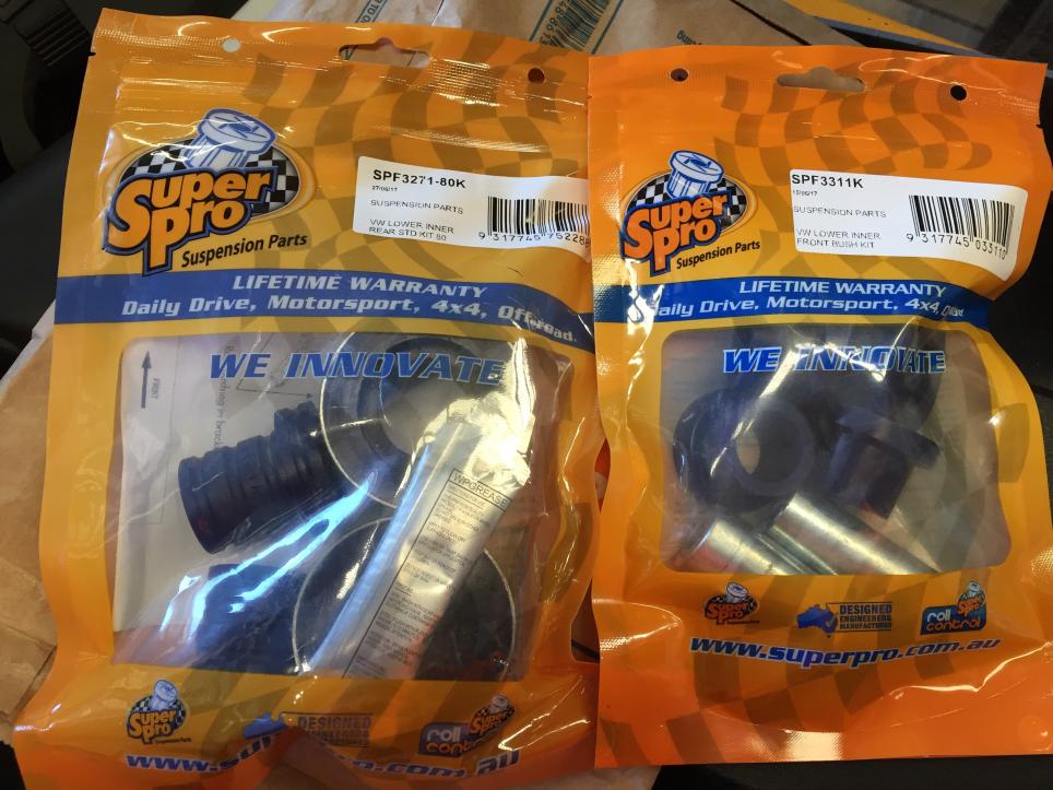

        Next on the list is bushings as I have this little thumping noise coming from the passenger side guessing it's the usual control arm bushing and plan on just changing them all just gonna go with the superpro bushings getting the front and rear front control arm bushings replaced as well as the dogbone mount something I should of done a while ago. Not gonna bother with the anti lift bushings just trying to make the ride a bit nicer
        • Love getting new parts control arm bushes turned up in 3 days now just need to find a shop to install them hopefully they won't charge too much
          • good stuff. you'll love it once you get those put in. feels ten times tighter.
            • I'm sure it will feel a lot better than the 11 year old bushes I have in there with 150ks on them haha I dropping the car off Friday morning for the guy to take a look and give me a price to install and if all good I'll get them done then.

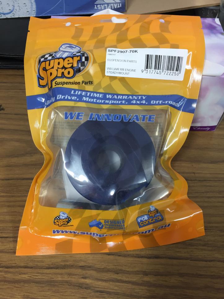

              • Another part to the puzzle has turned up the dogbone mount.
                Got the control arm bushings installed and it's starting to feel better hopefully this makes a decent difference as well then time for some new tyres my rears are thrashed and starting to thump haha

                      • dog bone is easy as. Just cut the old out with a hacksaw blade, its only a plastic casing or use a vice to push it out and the new one i pushed in by hand. Only took me 30mins
                        • Originally posted by NGT18T View Post
                          Was gonna give it a go but been under the car enough recently and easier with a hoist and the bloke is gonna do it for free anyway

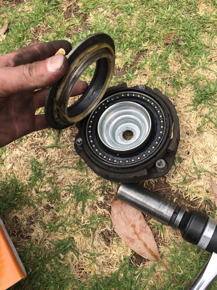

                          • Pulled out my shocks again today to replace the strut top covers and bearings and when I looked at the old ones they fell apart on me haha they were completely gone
                            Just driving around the block I’ve notice it’s a lot smoother now and the steering feels much better.
                            I also pulled out the dogbone to replace the bushing but the standard ones looks to be in perfect condition so I left it for now maybe in a few weeks I’ll hack it up and replace it with the superpro one
                            • Yeah the strut top bearings have been the bane of my life. I've swapped out 3 shagged ones in total and what I have in now is noisy as hell. They don't like you putting neg camber in from the bottom I can tell you that much. RE the dogbone, even if the bridges between the voids in the bush material are in tact, the bush is terrible. There is just so much movement. Once you have the new ones in it feels transformed.

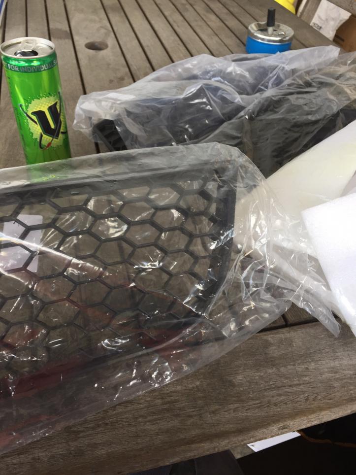

                              • Got myself some honeycomb lower grills thought they would just swap over easy but I was wrong lol looks like it will be a bit of a struggle to get them to click in properly but they do look nice
