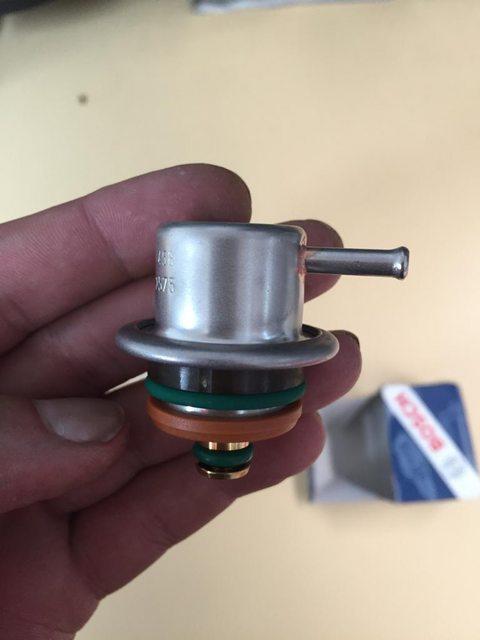

          • Ok called he workshop and they recommend the 4 bar reg for stage 2 problem is looking on eBay there are so many are they all the same for the vw? If someone has a link so I don't get the wrong one that would help cheers
            • Not sure if I should get some random brand off eBay or get a Bosch one like this
              • One of my friends was bored today and called around then turned up at my work this arvo with this
                So I'll call the shop tomorrow and hopefully I can book it in for stage 2 on friday
