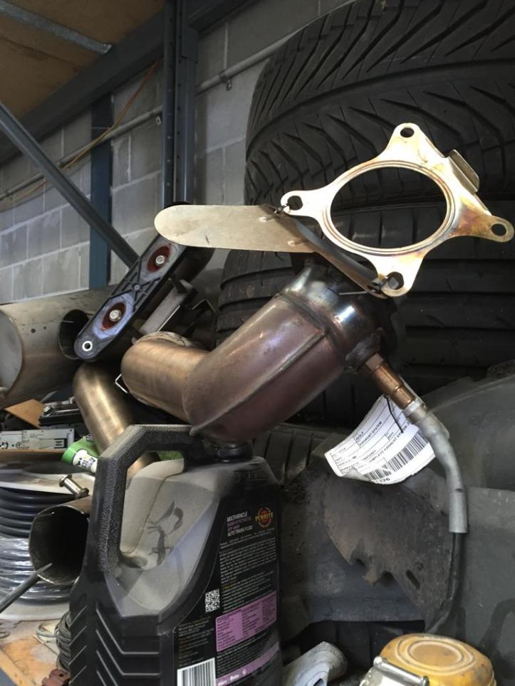

  • The new dump pipe should hopefully be on by this arvo can't wait to go stage 2 tune
    • Originally posted by LZY13B View Post
      That one won't be going on, it's off a MK5 or 6. The flange is wrong and that's just the start of it.
      Gavin
      • He will be cutting up my standard exhaust and using that flang he has been messing with it and says he will make it work so just gotta wait till tomorrow arvo to see the results but I'm sure some mods will be needed and he is a engineer so not really a problem for him

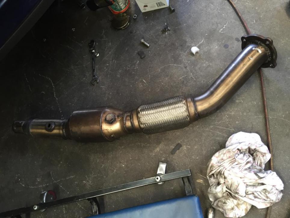

        • Well he has bolted the dump pipe on and made it work just needs to finish off the mounts and connect it to the rest of the standard exhaust so will be picking it up tomorrow just in time for the weekend so I'll get some photos maybe next weekend

          • Is that a stock MK5 or 6 or aftermarket 3 inch ?
            MODS- TOO MANY
            • ^ looks like a Milltek dumppipe from a Mk5/6 GTI.
              B9 Audi SQ5
              • Yes it is a milltek 3" dump pipe for a golf and he made it work on my polo the guy had a full exhaust system but didn't want to flash his car and just wanted noise so he was only using the back half so bonus to me lol
                • Just about finished he is just making a hole for the front o2 sensor then it's getting bolted up
                  He couldn't believe how restricted the standard one was he said I'll kill the clutch and blow the box next haha
                  • Just drove the car home and it feels good don't really notice a sound difference but it's spooling up quicker hitting 18psi just over 3k and is so much smoother it's been a month since I've driven it and dam I miss it lol I get the feeling I'm gonna need a new clutch when I go stage 2 lol
