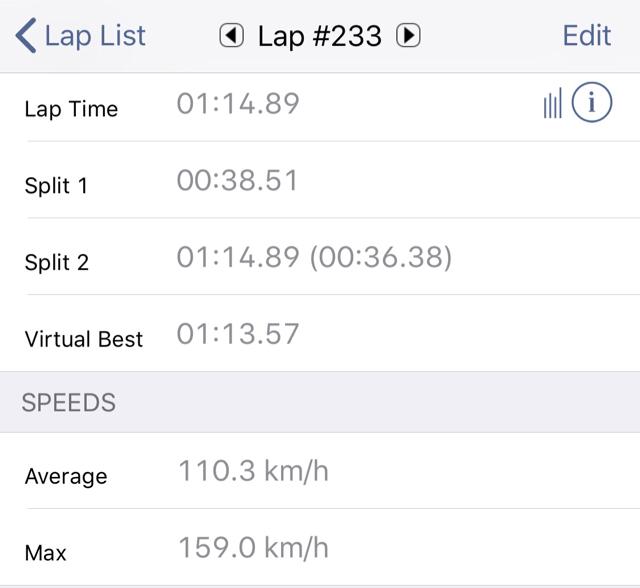

                        • First Wakefield day with the apr stage 1 and coilovers. Managed to knock a couple of seconds of my previous PB, and there is still a bit in it I reckon.
                          • If you give the date of the track day (preferably in the Polo Performance thread), then I can add you to the rankings there.

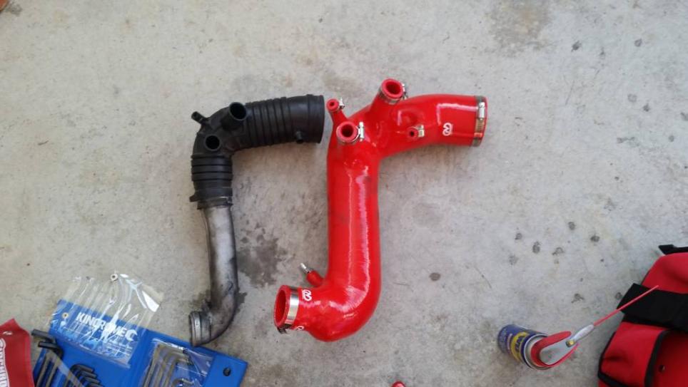

                            • Tried to install a oversize TIP on the weekend... couldn't get it to fit in place. I had the coolant pipes loose and the 3 bolts for the gearbox cable guide out but still wouldn't fit in place. Also trimmed some off the turbo side of the pipe to help. Beyond my DIY skills.
                              Sent from my SM-T815Y using Tapatalk
                              • Originally posted by Grant View Post
                                that is a big fat sucker.... and like the one I installed recently it looks about 2" too short. I cut mine in half and extended it with a bit of metal pipe
