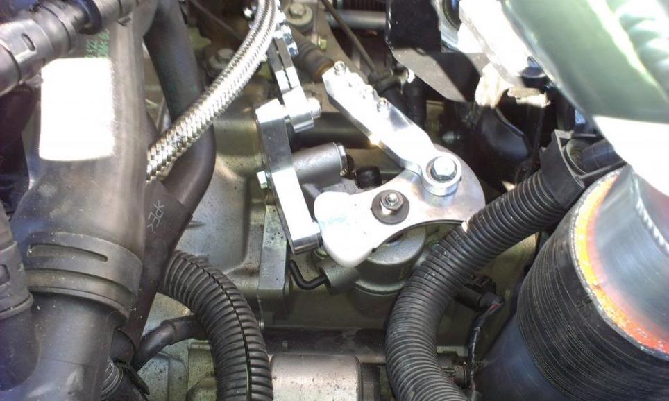

            Dieselgeek shift kit:

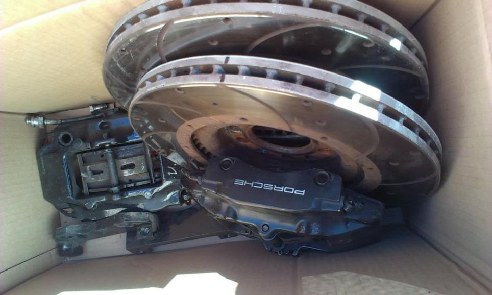

            Some goodies James dropped off to help make this thing stop:

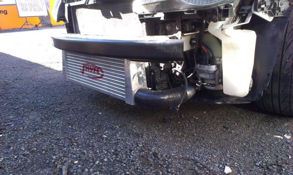

            PWR intercooler:

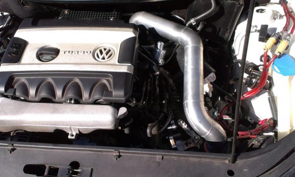

            Charge pipe rerouted:

            • that intercooler is huge, so nearly finished?

              • Originally posted by Njay View Post
                Nearly mate. Continual issues raising their head. Have to move the battery to the boot.
                Poor Seb. This thing just keeps growing. Hoping for the end of this week. (I've said that before).
                The intercooler isn't that big. It's 600x200. I would have bought the 500x200 but had to wait an extra week.
                This one just fits in front of the radiator.

                  • I like the IC location, is it welded to the crash-bar?
                    That hard piping looks dominant, going to be a CAI? will you use the original or foglight feed?

                      I didnt know that the Dieselgeek shift kits fit our polos ??

                      • Originally posted by Redliner View Post
                        Great looking Esky mate!! Bloody hell what size piping is that 2.5" - 2.75"??
                        • Originally posted by noone View Post
                          The intercooler is bolted to the bottom of the crash bar. It is a perfect fit. It should occupy most of the lower air intake real estate.
                          I wil run a 3in CAI. I wanted to use the original intake space for it but the intercooler piping stopped that. I will feed it down to just above the fog light. Worried about water being sucked up.
                          • Originally posted by vwthunder View Post
                            VW Short shift kit for MK4 5 speed
                            • Originally posted by VWindahouse View Post
                              Thanks mate. The PWR intercoolers are great value for money. Piping size is 2.5 inch both sides.
