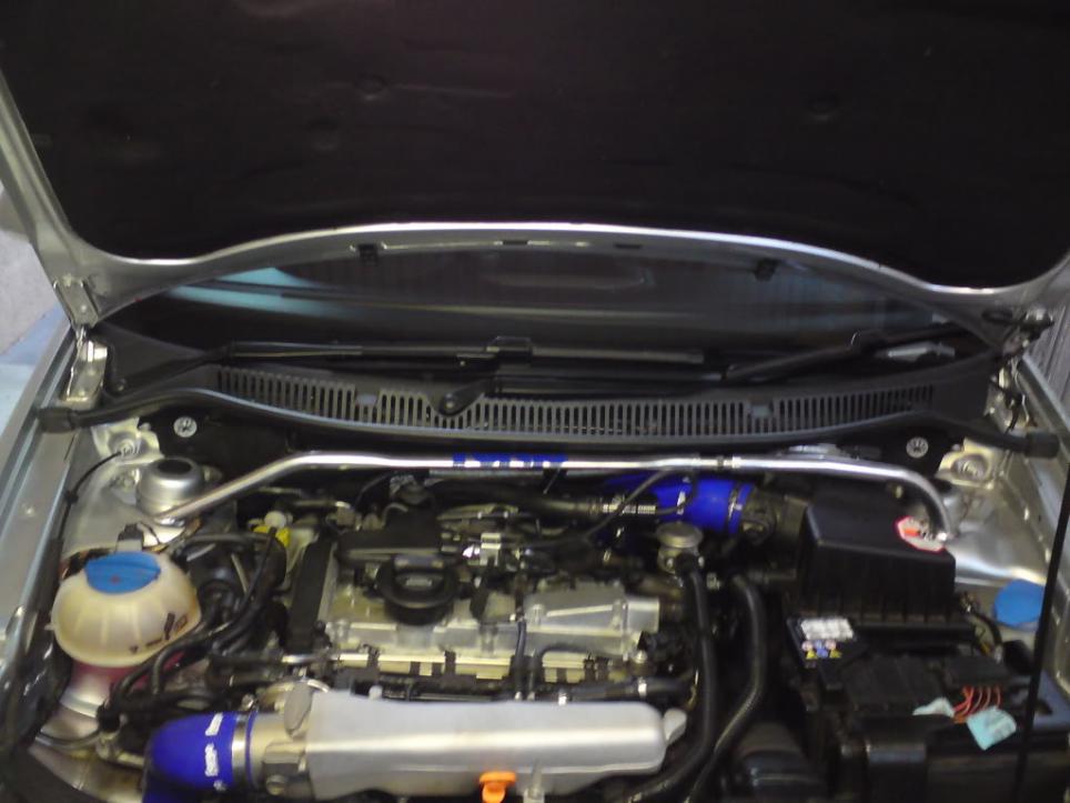

                • Yesterday I installed the SEAT Intake and K&N panel filter.

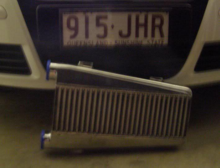

                        Do you think the Forge intercooler pipe is any good? Pics of the 2 like you did with the TIP would be good. I've been giving it some thought lately.
                        • I do like the Forge Intercooler pipe. It is alot more harder than the stock one, and I think it would resist ballooning better than the stock one too.
                          Replacing that is just a 5 minute job...All you need is a flat head screw driver and a pair of multi grips for the hose clamps.
                          • Today I changed my low beam headlight bulbs with 4700K PIAA globes. They look great.
                            I also attempted to change the parkers as I've bought some matching PIAA wedge globes, however I spent a good 20 minutes trying to get them out but couldn't do it! As a result I have cuts and bruises all over my hands, FFS!
                            It has to be twisted right? I can't get enough room for my hands to twist the casing that holds the parkers in. So frustrating!
                            I'll try again but looks like I might have to take off the headlights and/or front bar. Is this easy to do?
