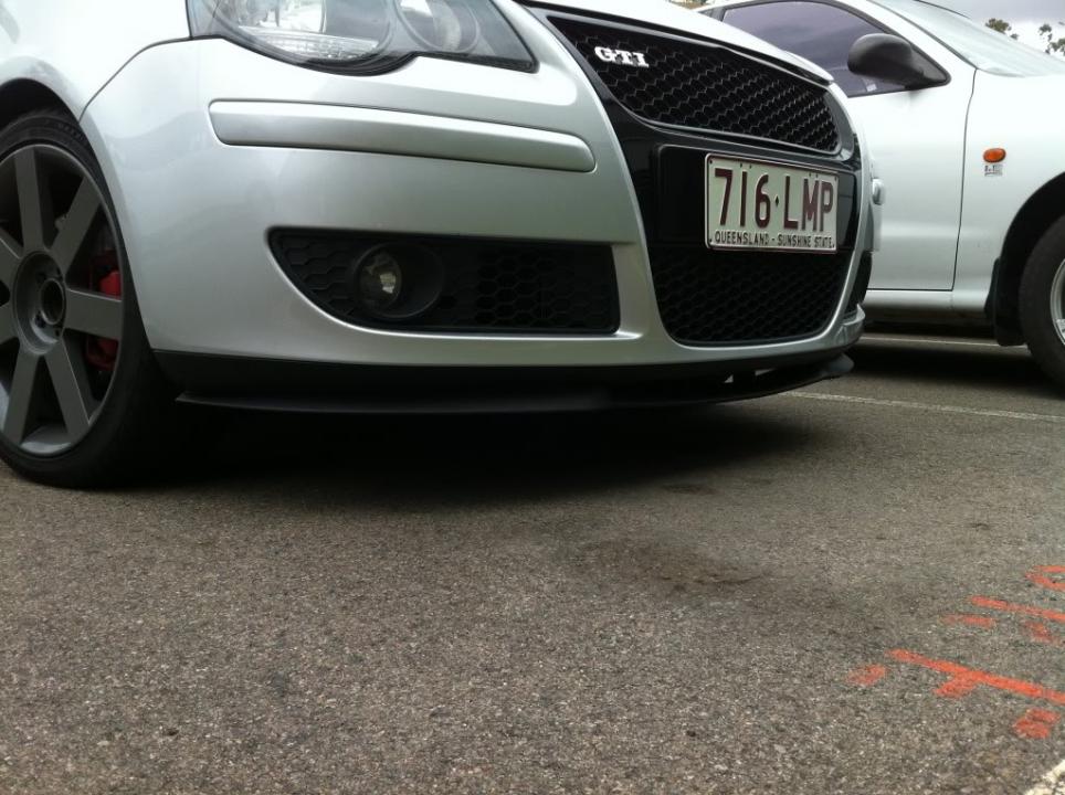

      Finally uploaded a pic of the front lip fitted...
      • very nice any front on's? Btw, where can i get a grill like that? Without the VW bag?
        • Originally posted by Blitzen View Post
          Now you need to lower it
          Looking good

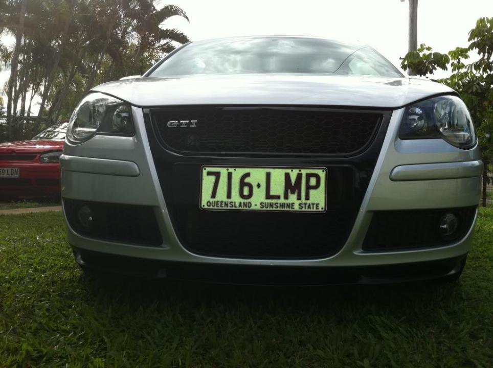

              Front on shot... Not the worlds greatest shot, but you can see the lip...
              With the debadged grill, I found the FK item on the Venom Motorsport site, but after trying to deal with them to get this item last year, I am pretty sure they won't send to Australia. Try them out though.

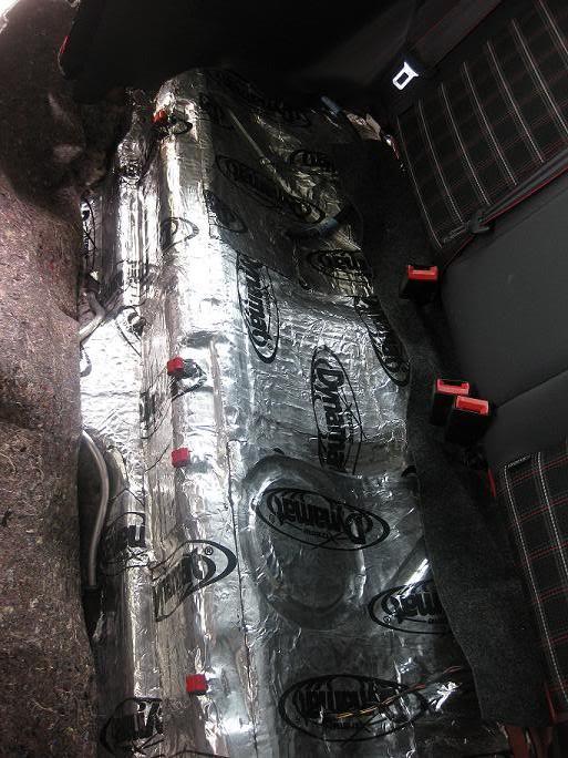

                • Worked on the Polo for 6 hours Friday till late and just finished insulating the rear floorpan and hatch, wheel well and wheel arches with Dynamat and Dynapad.
                  Now to hear the difference...........

                    Before we took the front bar off, we had no idea how to do it... We just plodded along, took the screws off on the inside of the wheel well, along the top of the bar near the grill, the clip in studs under the car, and the clips behind the fog light surrounds, and pulled the bar off... That took 15 minutes... Then it was simply a case of finding center on the lip and the bar, lining them up to where we wanted it, and drilling pilot holes for the screws... The lip is very flexable, so its easy to bend to the curvature of the lower bar valance... The whole job from start to finish took just over 2 hours... I think we did ok considering that we had never fitted one nor pulled the front bar off before.

                      • Originally posted by Polo GTEye N9 View Post
                        Snap - yeah i love the stuff -
                        I still haven't been able to figure out how to get the carpet from over the wheel arches without damaging it - so still have to do them...
                        and the hatch will be done whilst installing the reversing camera
                        • do you hear diffrence in noise clearly after using dynamat?
                          • Nice job on the dynamatting, always wanted to do that, any improvement in lowering cabin noise?

                            • Originally posted by instigator View Post
                              I just love playing with this stuff - results or not lol
                              my old BMW e30
                              Yes and no to the noise difference - it does noticiably lower the noise level but does not make all the noise dissappear.
                              Until i do the wheel arches like Polo GTEye N9 has done you still get plenty of road/tire noise which is where it seems the real problem is in the back.
                              The wheel arches has some sort of covering from the factory - but i cant get the damn carpet out to do mine in dynamat.
                              Another benefit is that it helps with an issue raised by Babu in one of the air con threads - the floor of the boot gets really hot above the muffler - the dynamat helps a little with this heat transfer into the car - probably not much but every little bit helps
