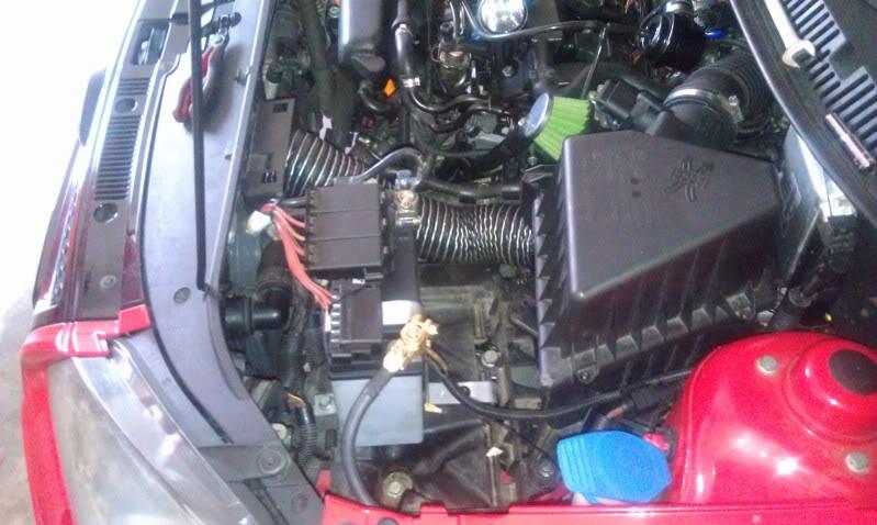

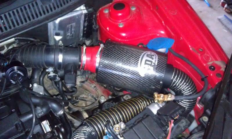

                        • Been off work a few days this week. Not been really busy with the car though, kids on holidays. I bought a DEKA battery for Greg Roles a few months ago, knowing that a decent airfilter needs the battery shrinking to fit.
                          I also picked up a BMC CDA last year sometime as well.
                          So yesterday morning I set to and pulled the standard battery out and fitted the DEKA. A simple aluminium strap over the top. I bought some brass post terminals off ebay and an 18 inch earth cable from supercheap. Although I recovered it in black heatshrink.
                          A quick cable tie to hold the fuse block and job done.
                          Then this afternoon I fired in the CDA.
                          I'll probably redo the airfeed into the space behind the passenger foglight.
                          Went for a quick thrash up the road and when I did a u turn to come back it stopped boosting. WTF. It's making about 2 PSI...
                          No fault codes, MAF output seems ok. I can hear the turbo whistle so I am sure it's not seized up or anything mad like that. I have wound the actuator right back but it was working on the way out. Maybe the nut fell off during the U turn? So the wastegate is now wide open.

                          • Did you consider putting the battery in the boot ?
                            MODS- TOO MANY
                            • Originally posted by vwthunder View Post
                              Couldn't be bothered Troy. Took me a 90 minutes to do both jobs all up. Would have taken hours to move it to the boot. Not sure if Anthony is planning on moving his still? I'll probably be involved in that, if he does.
                              Gavin

                                Yeah Gav wastegate must be flapping open mate, nuts would be locked tjhough but you know what these are like. They dont snap rods like the longitudinal ones so would almost rule that out, nothing vacuum would affect it as it would be off chop otherwise, must be venting out the wastegate. Never stops hey. Keeps it interesting
