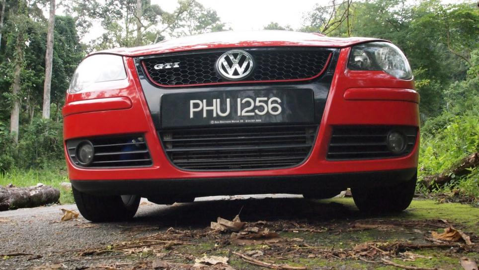

      Another option is to go for custom FMIC which is what I did few months back. Basically, the intercooler is coming from Evo 3 (500x300x65) and all new custom piping from from turbo towards IC and IC towards manifold. As for the drives, well, what I can tell though there’s a slight (very slight) lag of 300-500rpm for the turbo to spools but once the revs past 3k all the way to 5.5k, the car pulls with fatter torque figures and more rush feeling at high revs. It registered 216whp & 326wnm on dyno, I'm fitting in 4 bar FPR to fix lean issues at high revs, aside that this mod works like a charm!
      Some adjustment on the inlet/outlet needed, if Evo 7/8 intercooler of the same size, it would be ideal
      The old Evo 3 intercooler seems to be working well which defies its age
      The guy managed to make a hole when I didn't think it can be done
      Got to love the welds done by the Myanmar national staff, reminding me of seeing these things in the US
      Pretty stealthy too
      • #48
        verry good set up there!
        nice work done!!
        must be the nicest self made IC set up i've seen on a polo

                              VWThunder, you haven't got a intercooler yet on youre car??
                              do that asap and you will have more fun with the frankenturbo hybrid, it will hold its power wich you do need with that sort of set up.
                              i do know what you mean, also noticed it that the hybrid comes in more smooth as where a K03s realy burst in at low revs.
                              btw, wich hybrid version you have, F4 or F23?
                              • #60
                                Yes it has a Forge Intercooler
                                It was fine on the K03 but now I really noticed it not standing up to the job
                                Might get a custom one and some water meth are on the cards
                                MODS- TOO MANY
