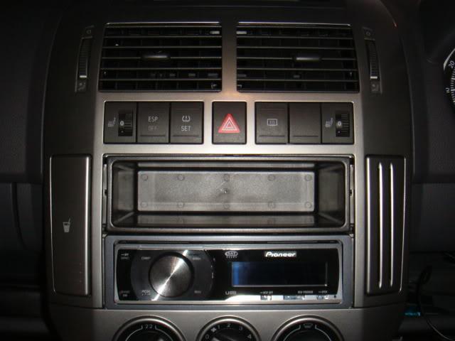

                            Hey, dont get the single din fascia kit above, i got it, and it doesn't fit, i ended up using just the pocket. the seller only recommended me the double din one. then i saw the single din one thought it would be the same, but found out the hard way

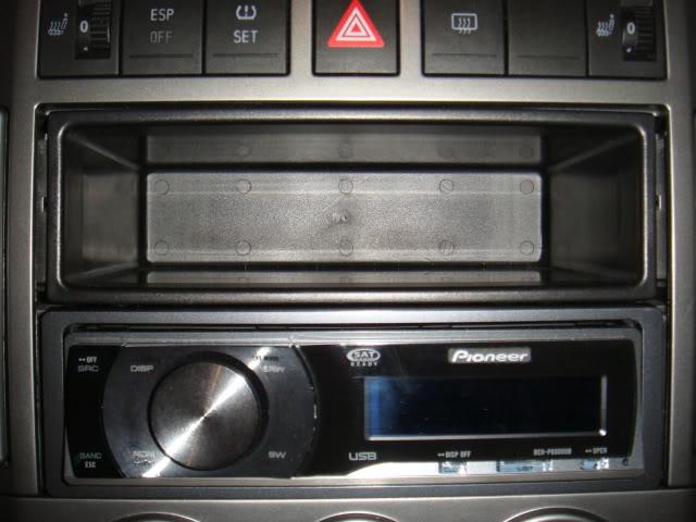

                            • Originally posted by xc17ed View Post
                              Good point that I hadn't noticed.
                              Sent seller a question regarding that.
                              Tough decision as I already have a single din Pioneer DVD from the previous car, or to sell that and get a double DIN... hmmm.

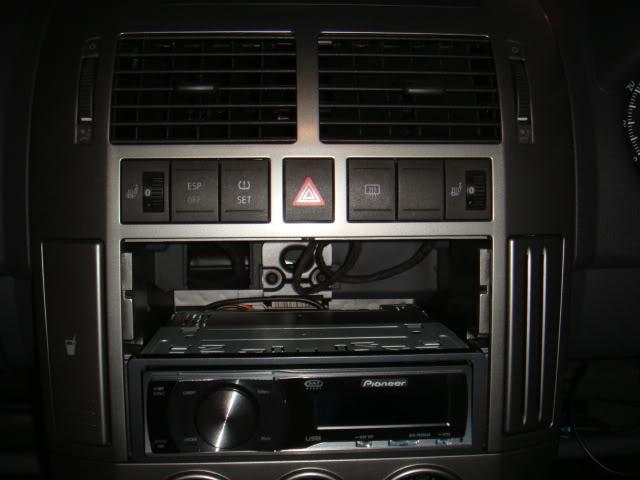

                              I fitted the single din HU with the metal bracket from pioneer, and a pocket, which comes with the fasia kit that i got from ebay that didn't fit. i believe you can get the pocket from JB hifi for $15-$20. the pocket moves abit, and it does not look factory, but im happy with it for now.
                              Here are some pics:
                              Black|APR Tuned|APR Dogbone|SEAT Intake|BMC Airfilter|Forge TIP|SEATSports Front Strutbrace|Forge Rear Strutbrace|Whiteline RSB|Bilstein B8 & H&R Springs

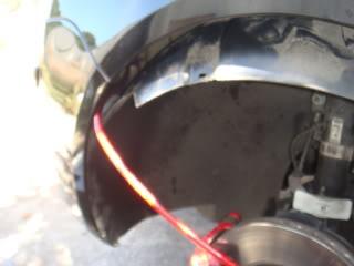

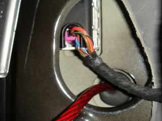

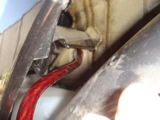

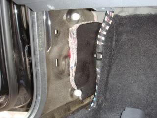

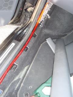

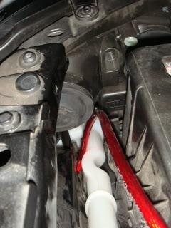

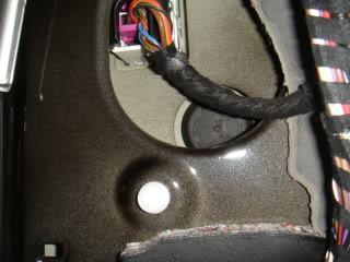

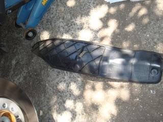

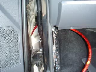

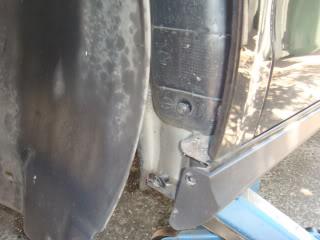

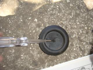

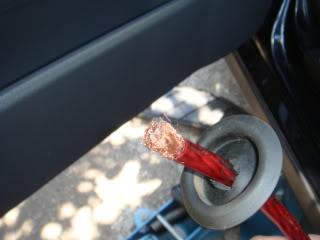

                              • Power cable - through kick panel, front guard, into engine bay
                                Ran my power cable for the sound system yesterday.
                                Here are some pics:
                                Remove left (passager side) kick panel (unscrew/remove the tray under the glove box, as it block the top part of the kick panel)
                                you will find a rubber cover, access to the left front guard, near the door hinge
                                jack up the car, remove the front left wheel, remove the screws that lock the plastic guard under the front guard (i only remove 12 screws, from right to left, and left the screws under the bumper, i had enough room to work with)
                                remove the rubber guard/cover behind the guard, (only one screw), you will gain access to the door hinge from there.
                                remove the rubber cover you saw from the 2nd pic. you can easily push it out, from inside the car. poke a hold, then push the power cable through it.
                                Then feed the cable through from inside the carbin.
                                Dont put the rubber cover back in place until you have the right length, feed the cable through to the hole in the front guard into the engine bay, it comes out next to the water bottle and battery.
                                all done. you should be able to figure out the rest, i didn't have to remove the rear trim, just pushed it through the gap and you will see it under the back seat, sorry didn't take a pic of that. if you are upgrading the rear speakers, you will have to remove the rear trim anyway. hope this helps. cheers, Kevin.
