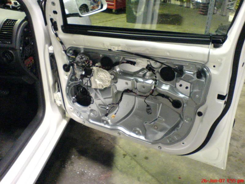

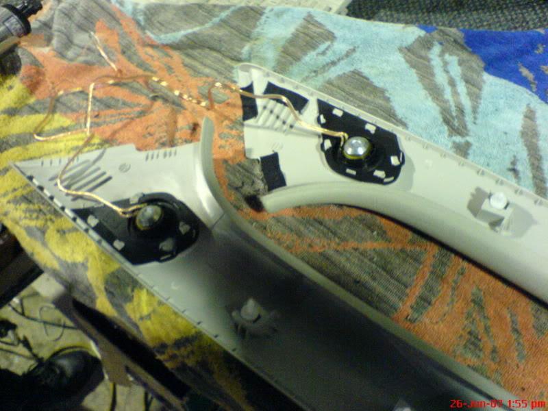

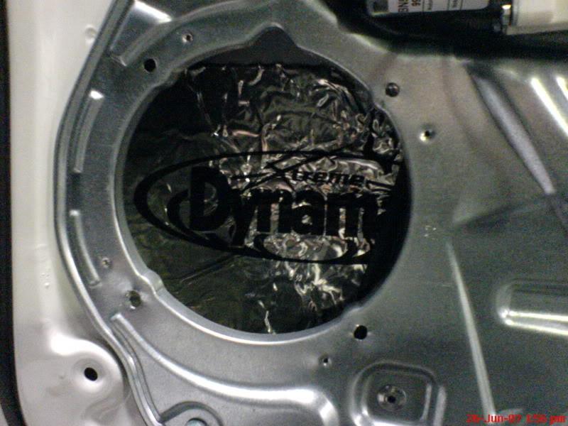

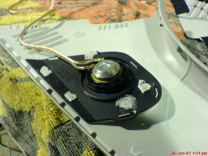

                  No prob's. Here are the few that I do have. Sorry for the quality!
                  Stock speaker has 4 rivets which need to be drilled out; mount the spacer checking for clearance on the door card; and away you go. Little bit of stuffing around, but no more than any other new car.
                  Didn't take any photo's of mine as it's the only thing I let the pro's do (as the speakers were up the top end of 3 figures). Took plenty of the rest though, as that was all done DIY.

                      How did you hold the tweeter in place? i managed to took the a pillar out and took the stock tweeter out and i'm trying to figure out how to hold my new tweeter. Thanks mate.
                      Black|APR Tuned|APR Dogbone|SEAT Intake|BMC Airfilter|Forge TIP|SEATSports Front Strutbrace|Forge Rear Strutbrace|Whiteline RSB|Bilstein B8 & H&R Springs
                      • #86
                        Originally posted by ef9 View Post
                        Hi Jon,
                        Use a silastic or silicone product. That way it isn't permanent should you want to remove them for whatever reason. Pretty sure that's how mine were done as well.
