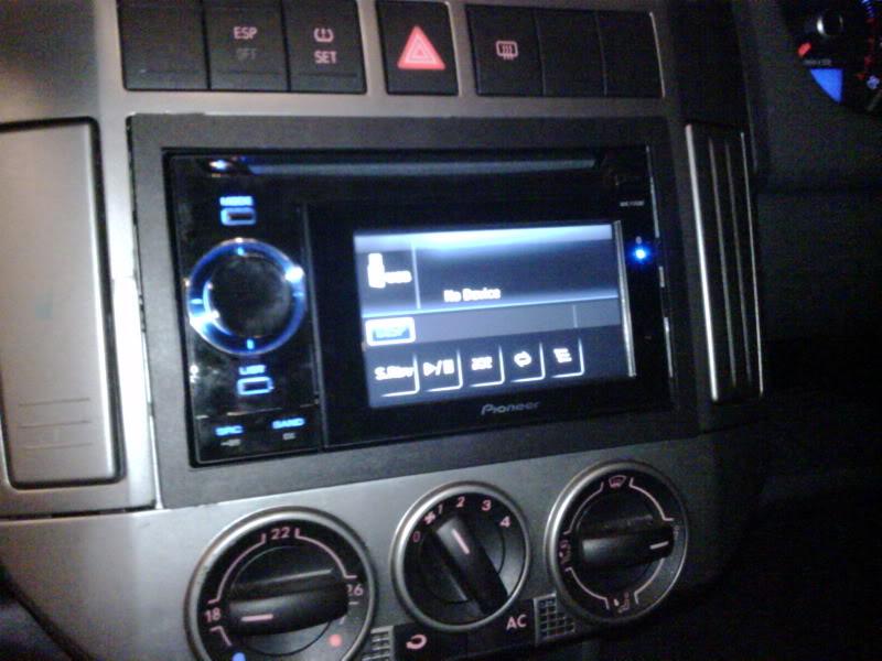

                          Heres the unit installed:

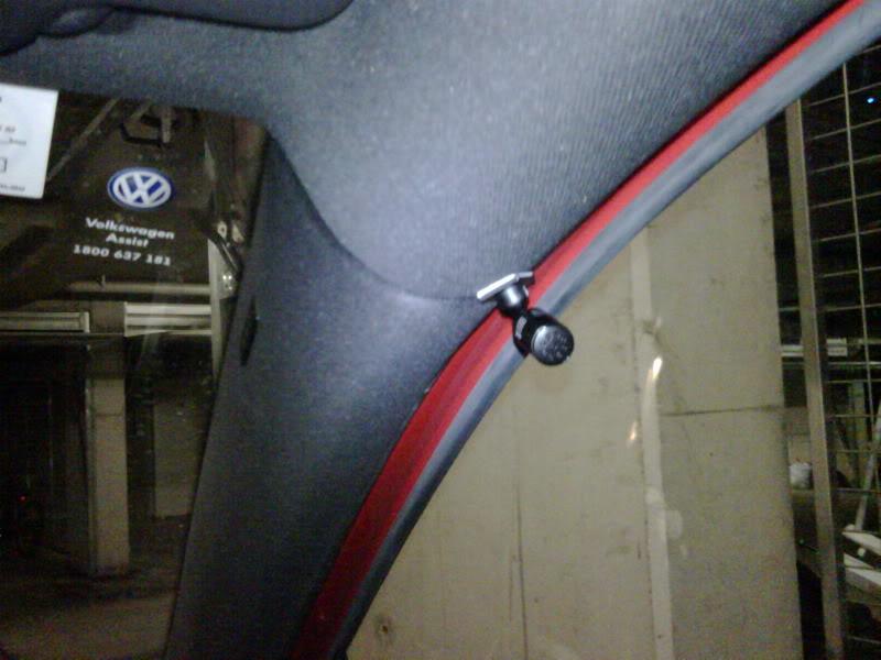

                          Mic run up the A-pillar:

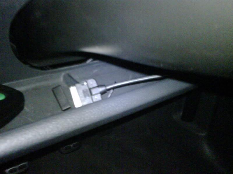

                          iPod connector run under the steering column, popping out in the tray underneath:
