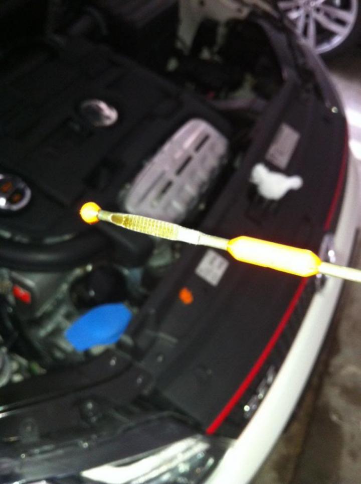

          • 18000km and on normal Mobil1 5W30 3.75L (4quarts) for the past 3000km, oil level has not moved on the dipstick.
            I always check my oil using this method, a fully warmed up(88-92 degrees) engine and parked it for 20mins. I did try to check oil before I start the car in the morning and it shows the same level on the dipstick.
            Anyone knows why VW specify to check oil with a hot engine? My previous Japanese cars are specify to be checked on cold engine.
            Attached are the photos of my oil level, sorry for the poor quality as taken from a normal camera phone.
            • I think it's because when the engine is cold all the oil has gone to the bottom of the engine/sump.
              If you check the dipstick it could show as over full and you let some out (to the full level). Once you start the car and warm it up and it is spread all around the engine (in the head, cams, valves) it will show the level as low which is not good in high revving situations as the pickup pump can struggle to give a continuous flow of oil.
              • Your kidding? ROFL.
                • Nope I'm not...I said "I think" not "I know" but it does it on mine and every other engine I have had so I would love to hear your explanation on the matter...
                  It's not as much as much as a difference as I said though. I could measure mine at exactly half full when stone cold and after a normal run be at 3 dots (I have about 20 dots on the disstick) lower than when cold.
                  • Your supposed to measure hot but after xx minutes wait.
                    It's because hot oil expands but they want all the galleries & valleys to be drained.
                    My personal ROFL theory for this is that they want the oil level to appear as high as possible to cover up how much the engines are using.
                    I think as long as you check your oil occasionally it doesn't matter whether it's hot or cold - just use the same method all the time. It's still more than what most people do.
                    • Originally posted by kevinctr View Post
                      Kevin, I do the same (about 20/30 minutes after engine stopped when 90°C at least), but I usually find some differences when cold: usually one dot of the dipstick less compared to hot engine.
                      I read somewhere that those last generation oils are very sensitive to temperature expansion, that's why VW reccomend measurement with hot engine.
                      Furthermore, suggesting this kind of measurement, they avoid mistakes when cold: if you take out the car form the garage and you measure the oil, even waiting 20/30 minutes, you will never have a correct measurement, because oil when cold will never completely come into the sump...
                      BTW, your oil colour seems to be very similar to mine: light brown...
