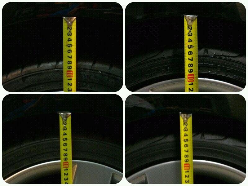

Didn't realise they were staggered fitment so I now have 9inch wide rears lol
Anyone know how tight its going to be? 9inch with a 38 offset. Should be fine but might need to get the tyre shop to do a few test fits with different tyres.

Fwoaaaar....sorry to be the bearer of bad news but 9inch et38 will seriously poke out more than you want but not only that, your car is lowered so you are met with a conundrum I'm afraid.Originally posted by BLN355 View PostDidn't realise they were staggered fitment so I now have 9inch wide rears lol

Worked it out as 32mm more outwards and 18mm inwards over standard.
There's a fair gap atm (about 20-25mm) from wheel face to guard so hopefully there isn't too much "poke". I'll do a trial fit minus tyres on the weekend and see what im working with.

I understand the numbers and the gap you presently have ...but its just not that simple. Forget about the tyres for now because they'll most likely be narrower and stretched anyway but the 9inch rim itself poking out that far will absolutely give you massive headaches because of how low your car is...and it is low.
An 8inch ET35 wheel isn't even flush with the gti guards, it marginally pokes out too....just anyway.
ET46 (stock 7inch wheels) + 8mm to get ET38 (new 9inch wheels) + 25mm for extra inch on outer edge = 33mm further out.
Those online offset calculators are a piece of crap too because they don't take into account, one, two and three piece wheel configurations which can all have different offsets for different widths for different lips and barrels. I learned a heap about all this through liaising with an experienced consultant from (insert bespoke wheel company here). This is why I'm going bespoke on my new DPE wheels as I want them to fit the car, suspension, guards and brakes to the absolute millimeter. I want the perfect stance and a ride setup which looks great but doesn't prevent me from some spirited driving now and then.
