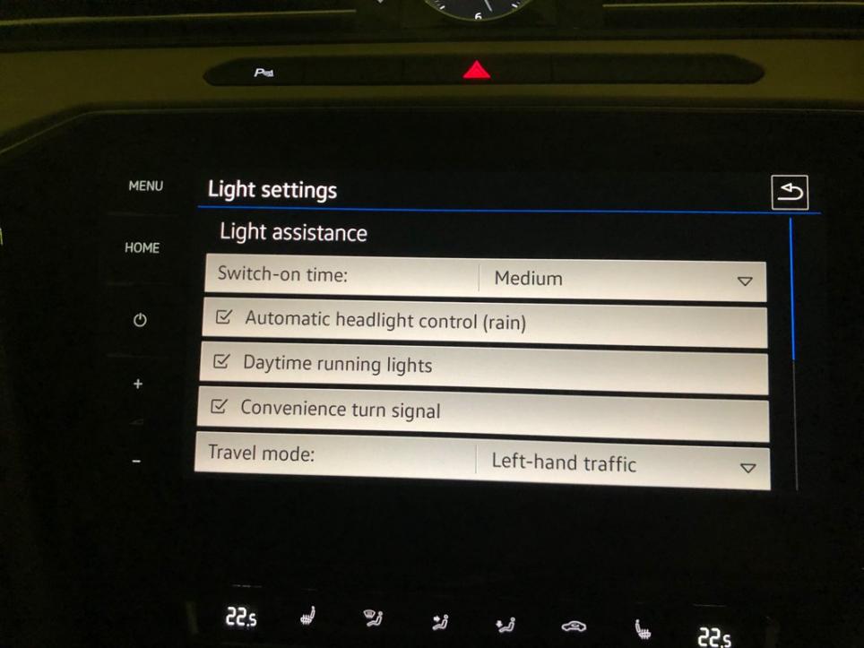

    • i have it now coming up and configured to 'late'...still think the lights come on too early.....thanks everyone for response
