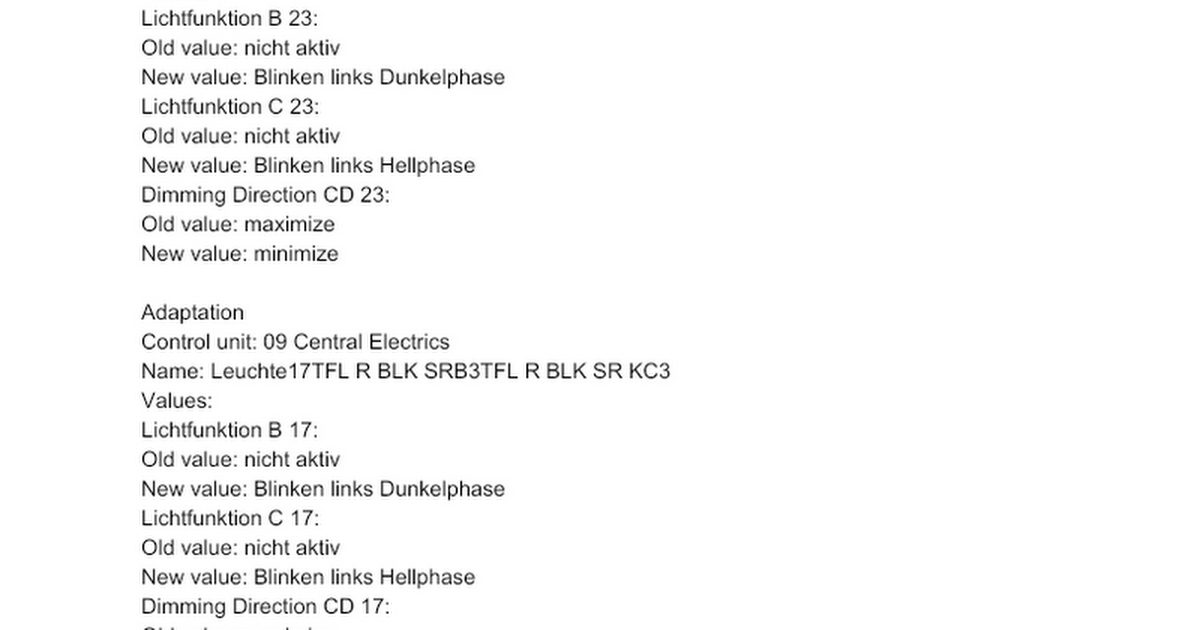

                  Well havent ever had a Carista but would say that the other is more useful and can do a lot more than just diagnostics Eg I did 36 mods to my Tiguan most of which a Carista would have had no idea about. Go here and look OBDeleven You need a PRO licence for it to work well and unfortunately since 2020 VAG have made it harder for us to modify some things EG cant disable S/S electronically anymore Here is a list of most of what i managed to do
                  -------------------------------------------------------------- Urban joke/pace car tails (2019 GSW with OE LED tails) Adaptation Control unit: 09 Central Electrics Name: Leuchte23SL HLC10 Values: Lichtfunktion B 23: Old value: nicht aktiv New value: Blinken links Dunkelphase Lichtfunktion C 23: ...
