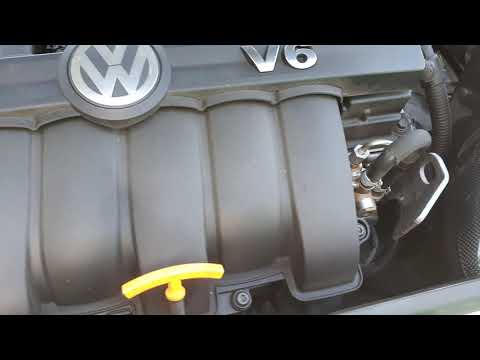

    Hey guys,
    So as many of you know, this car has no service history at all (apart from my own).
    What appears to be at random, the car has started to make this noise from what appears to be the right hand side of the motor (near the end of the video it is more prevalent).
    Just wanting opinions on if this sounds normal, the car isn't at full temp here but it's definitely warmer as I was driving around 30 minutes before.
    I've checked the timing chain via VCDS with blocks 208 (-3.0) and 209 (-2.0) as per below (this was around a week ago). This was in the past (Sixish month ago) -3.0 and -4.0 so this seems ok from what I've read but I suspect it could still be bad or potentially the tensioner.
    Have had almost all fluids (except coolant, that's to be done soon) changed since I've owned it. Last oil change was around 2,000k's ago with 5w-30 Fuchs. I'm thinking a 5w-40 may be good, but is this just hiding the issue?

    Any suggestions are welcome, I'm getting no loss of power and no timing related or engine codes at all. The only codes that I've seen (and not fixed) are the parking sensors which is obviously irrelevant to the issue. I will do another scan later today or tomorrow to confirm however.
    Bump, fixed video link!
      I've got the same type of noise coming from same side of the engine (though mine is only 3.2 LT engine). I doubt the noise would be from the timing chains since the engine is transversely mounted meaning the timing chains noise would be coming from LHS standing in front of the vehicle. And yours seem to be more from the RHS. Regardless, your readings are obviously within specs.
      I'd be looking more at the direction of fuel pump (cam follower) issue as described in the following you tube clips HERE, HERE and HERE. A while ago I read a thread (on this forum) on this particular topic but I'll be buggered if I can find it now. BTW - I'm getting an intermittent Low Fuel Pressure error code similar to the one described in the you tube video but I don't get any engine check lights or any other obvious symptoms. And since I've been busy I haven't checked my car for the above problem as yet but suggestions seem to be a check 30-50K km. Let us know what you found.

                        Additionally used a stethoscope on the HPFP and it seems that maybe the noise too. Compared this to another R36 and mine was louder. Mine was also warm and the other was cold, so who knows? Still no codes reported apart from the MAF being unplugged (whoops).
