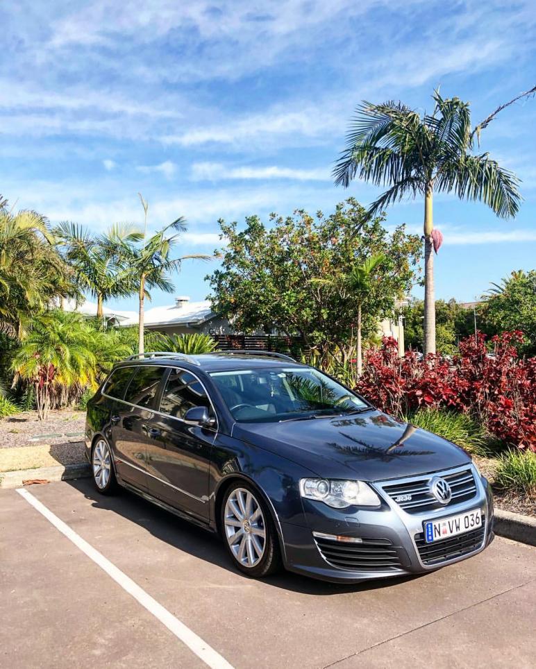

    My car is due for new shocks.
    I am running KW 20mm lowered springs and the OEM Sach ones have lasted me 140,000kms.
    Do i stick with OEM or go Bilstein B8's?
    What has everyone around here done?
    Pic for clicks
