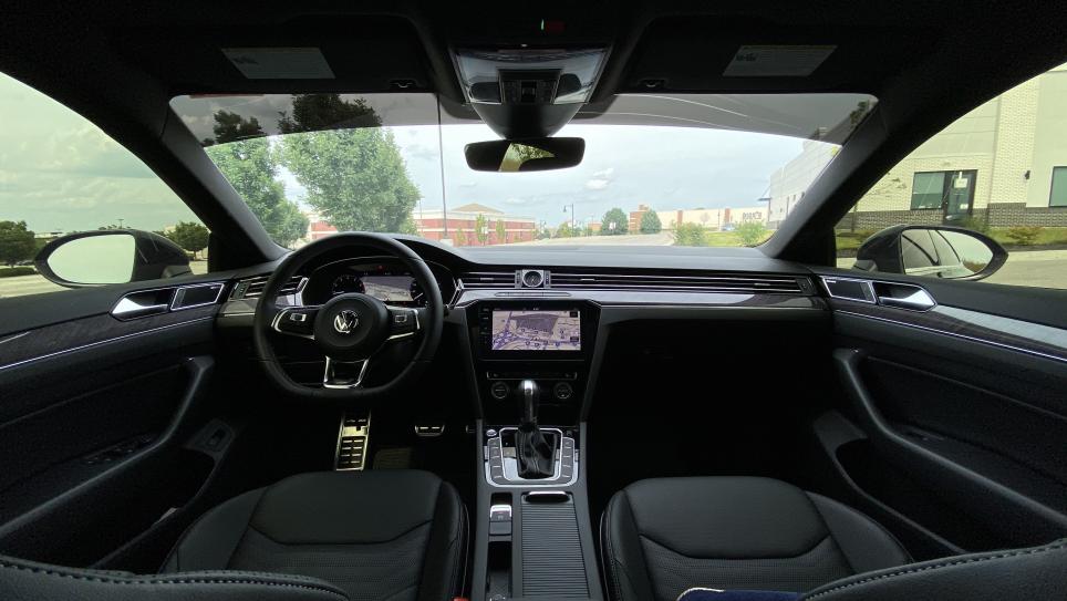

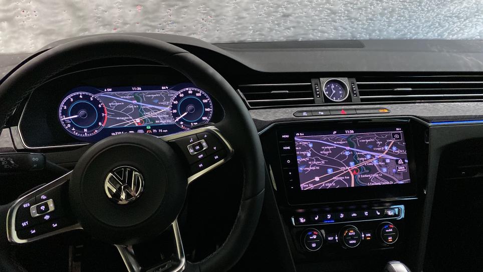

Edit - here's a night photo:
Edit 2: so... my wife just pointed out that I'm a dumbass (in a nicer way). Turns out that the car theme is set to the ambient light color. Here's a photo using her personalized key:
