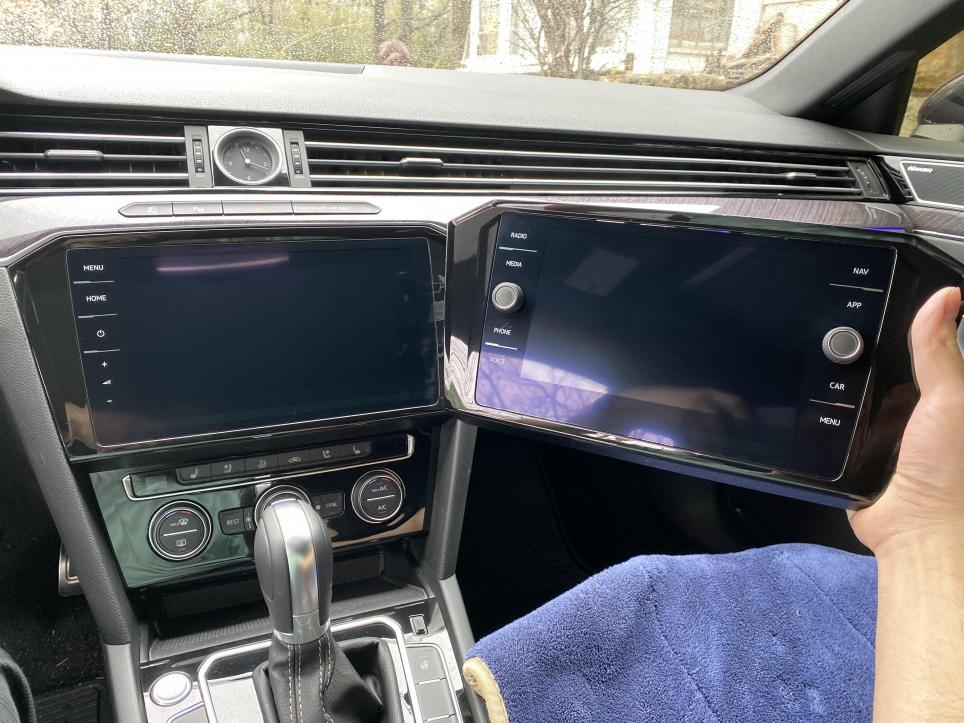

                            • Any body here with the Discover Pro with Gesture control share the 5F admaps and long coding? I swapped out the NAR Discover Media with Nav for the Discover Pro. I just to compare what I have with someone who already has this from factory. Thank you
                              Sent from my car phone.
                              • Originally posted by SdvolksArteon View Post
                                Here is a link to my 5F dump:
                                Microsoft OneDrive - Access files anywhere. Create docs with free Office Online.
