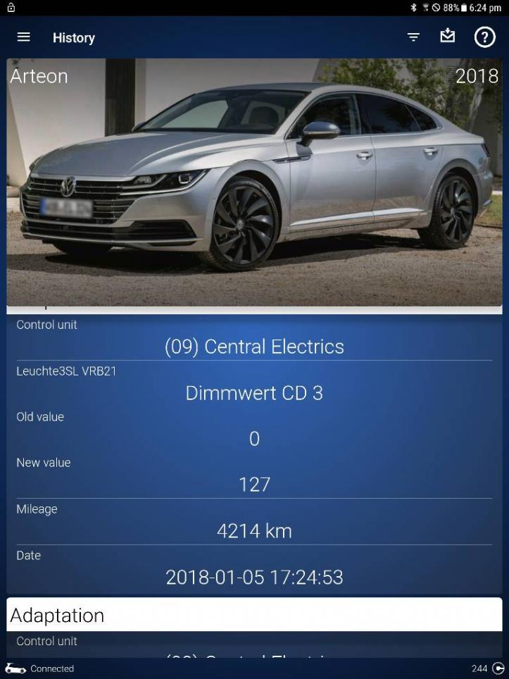

                    Confirm but with the prefix that i did mine via obd2
                      Same with drl front light intensity along with Scandinavian rear drl

                        Originally posted by Blackpaladin67 View Post
                        Would love to see your work up coding on this one . When i attempted it mine spat the dummy and got two warnings come up on the dash.

                            I find the drl thread it was from the golf forum with a link to a external site with needle sweep and several other mods.
                              Hi this should point you in the right direction, with luck
