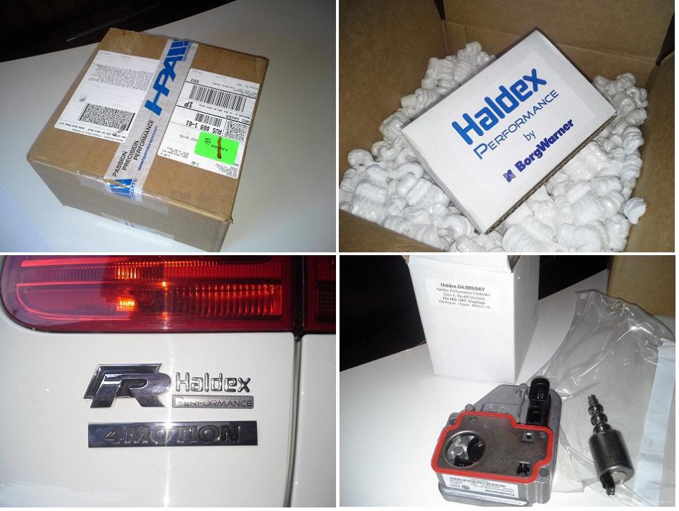

                            • Performance Haldex Controller Tiguan
                              After getting my 4 Motion back, I thought why not give it a upgrade and have some fun. So a performance haldex unit arrived from HPA motor sports Canada. I did not bother getting switching cable or remote because unit by default is in race mode and I intend to run it like that.

                              • Originally posted by Ramee View Post
                                Looks well packed. Sorry for my ignorance but what's it meant to do?
