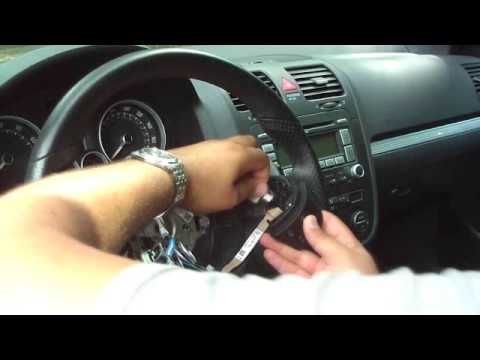

        That is a great idea! This video shows how to remove paddle shifters .. But no idea about the electrical connections availability..

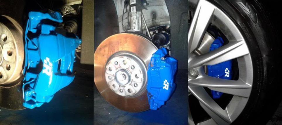

                          • Today Tig got it's brake callipers painted. I just managed to paint front pair only. Tomorrow will do the rear.

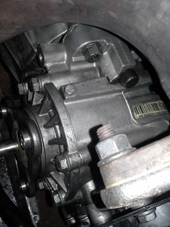

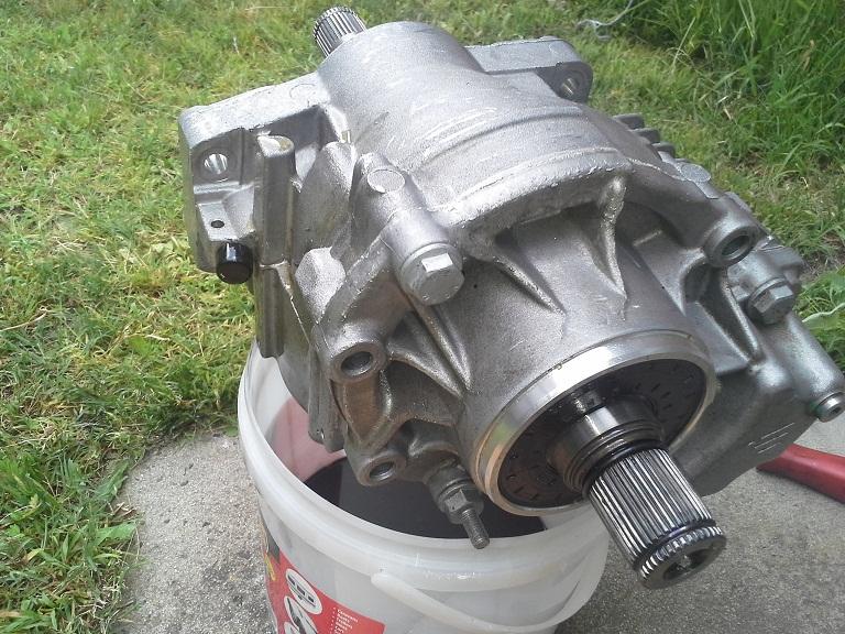

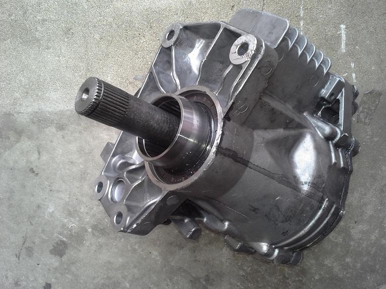

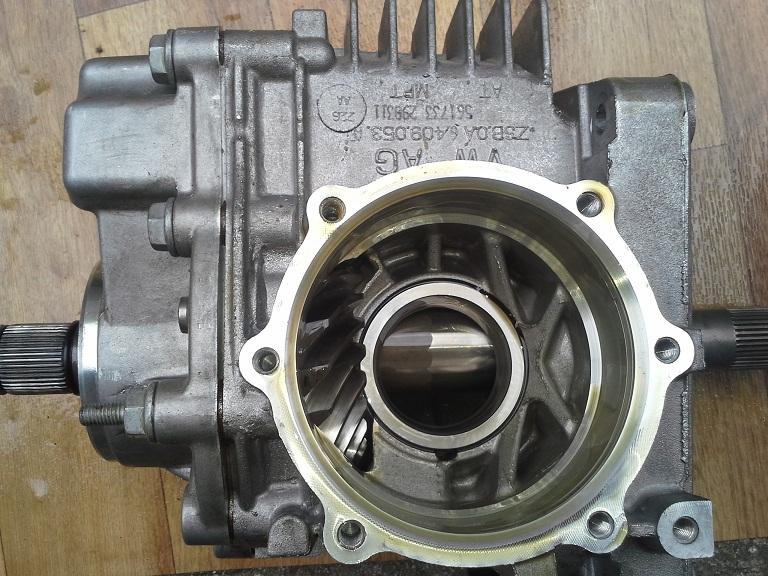

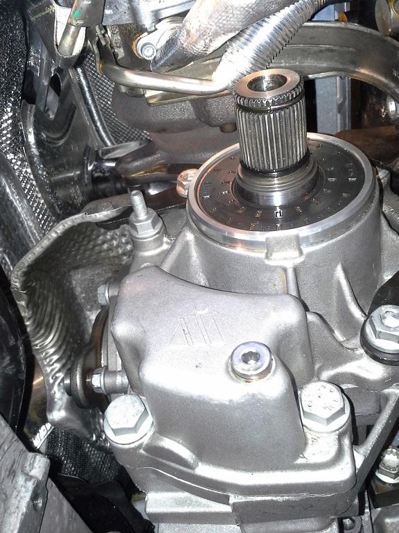

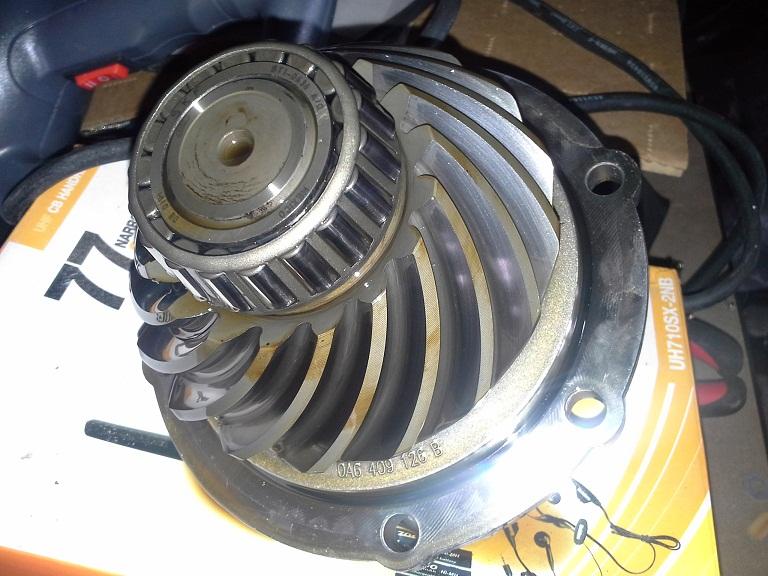

                            • Tiguan Transfer Case Replcement
                              Last few weeks my Tiguan was unfortunate enough to loose power to its rear wheels causing ugly front wheel spin on spirited take-offs in first two gears and sometimes even in third in wet conditions. And initially I thought it could be a haldex malfunction but then realise it is a problem with front transfer box which deliver power to propeller shaft. Actually there were some symptoms before completely losing my rear drive such as slight jerks and slips when accelerating hard like traction control kicking in. But actually there was no ESC light flashing on the dash! Finally I lost my rear drive completely and front wheels started to slip even normal takeoffs.
                              Finally problem was narrowed down to transfer case and with the help of Guy from HP I got a very low mileage transfer case and replaced the damaged one.
                              Original Transfer case on the car with propeller shaft removed.
                              Removed from the car

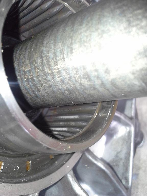

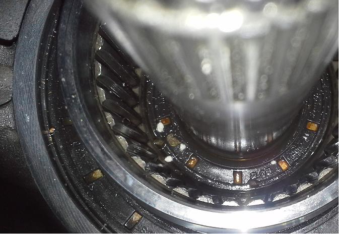

                              Dissected!
                              Connection between that gearwheel and the shaft has severed!
                              Other gear drives the propeller shaft..
                              Oil is very dark and mixed with metal particles..
                              DSG output for transfer case and driver side wheel.
                              There was a slight confusion due to different spline profile of original unit and new replacement.. But soon found out original one is same as new one with splines slightly tapered at the end for easy install.
                              Original splines
                              New replacement unit splines

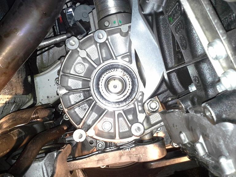

                              New Transfer case installed.
                              Finally good to have 4Motion back

                              • Originally posted by Ramee View Post
                                Dissected!
                                Any idea how this broke? 1 too many launches???
                                And I'm still trying to figure out which bit is actually broken. By looks of things both gears still mesh together OK (no teeth stripped off). Is it the gear in the case that has come off it's shaft? Any idea how that can happen.
