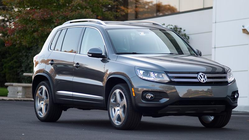

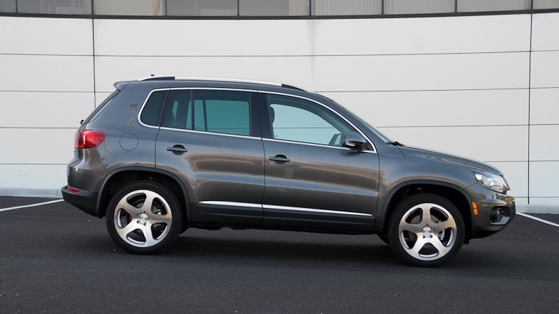

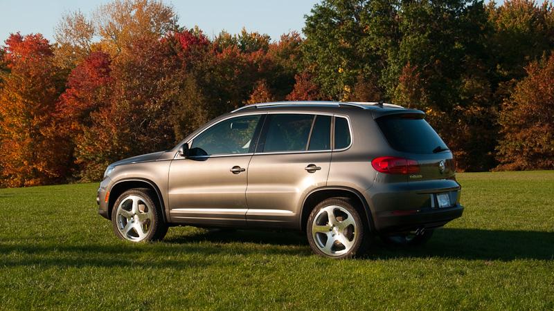

                        • Stolen from vortex:
                          WHEEL SPECS:
                          ?|? Rotiform Wheels ?|?
                          Rotiform NUE cast wheels
                          19x8,5 ET35 5x112
                          TIRES:
                          255/40-19
                          Pirelli Scorpion Verde All Season
                          • Wow they look small for 19"s! Maybe coz of the ride height.
                            Forever blowing bubbles.
                            • Originally posted by Pullstarter View Post
                              All 19's look small Simon
                              Mine look smaller still thanks to the stepped lip.
                              • Yeah true, my 20"s look too small lol.
