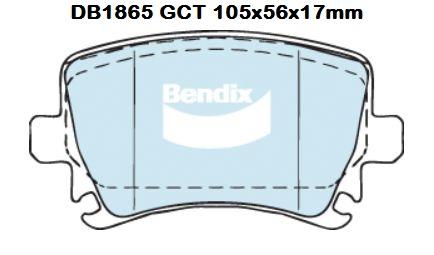

      Brake pads rear NOT DIY Friendly!
      You will need VCDS to replace pads and perform basic setting (electric parking brake) and the proper power supply that will not demage the car's electronics. The mistakes during the pads replacent could be expensive.
      Bendix DB1865 GCT (aftermarket alternative)
      Thickness: 11mm (not incl. metal backing)
      Min. th. 2mm

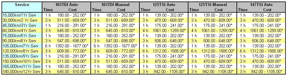

              Service costs
              According to CarService.com.au Service Guide at January 2010, you can expect to pay the following for your Tiguan services:
              http://spreadsheets.google.com/pub?k...=0&output=html
              NOTE: The prices listed below are indicative prices only and we can not guarantee that the price displayed will be the same as the price quoted by the service centre. Please ensure you clarify all costs with your nominated service centre prior to booking.

                    Rear brake pads are now available from BENDIX the p/n DB1865 GCT
                    http://bendix.com.au/catalogue?manuf...&oepart=&part=
                    I use Bendix GCT on my T5 at the front and they're good very low or no dust and it looks like they will last much longer than the OEM pads.
                    I hope they will make front pads for Tiguan available soon. I don't like that dust on the wheels.
                    edit: ATE has now the ceramic brake pads available and I have fitted them on both our Tiguans, front and rear and am happy with them, no black wheels anymore, the wheels are easy to clean now.
