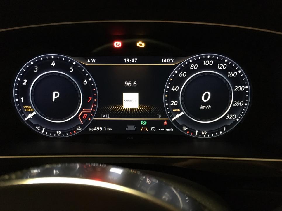

            • Originally posted by veew View Post
              OMG that is awesome!
              I thought so too!! I really liked the look of the AID layout on the new Golf R so am glad have been able to find out how to replicate it.
              You can even combine it with the Display Depiction modification to give it the orange colour as well:

                            • Originally posted by sharp View Post
                              Looks really cool. How did you get the blue lines?
                              The Blue lines are the default setting when you change to Variant_4 as that ties in with the Golf R colouring. If you change the Depiction setting then it goes to the orange/gold colouring.

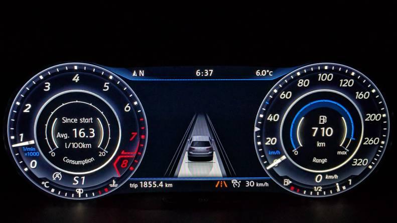

                                As NZ_GolfR said, Variant_4 and blue is default.
                                Combined with the "consumption and range" view.
