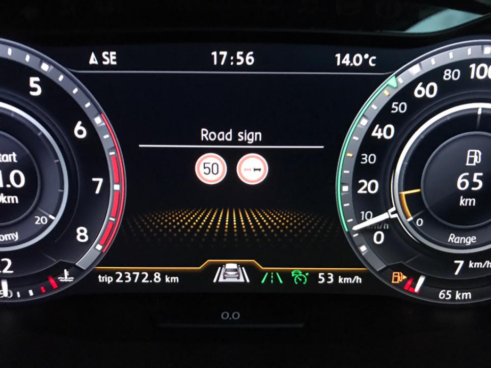

    So far mine has shown 2 signs. I drive pretty much the same routes every day so never really get the chance to drive past different signs.

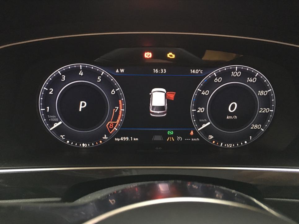

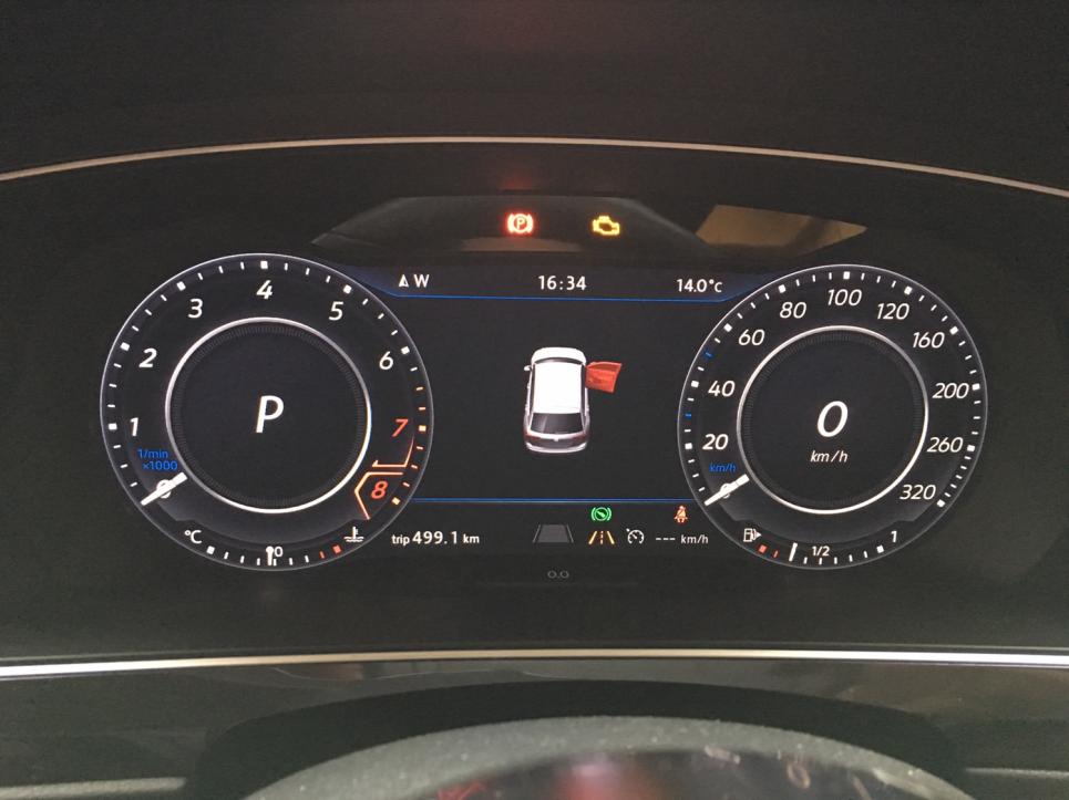

                              Just did a bit more playing around today after reading some of the Golf 7.5 forums and found you can change the AID display to look like the new Golf GTI (without the red lines):
                              Or the Golf R (notice the 320kmh limit!!):
                              It is under Dash Board (17) - Adaptation - Tube_version (all the way at the bottom on the list)
                              Variant_2 is the default
                              Variant_3 is the GTI
                              Variant_4 is the R
