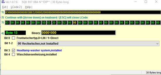

          • Hi Guys, anyone know of a way to disable the headlight wash function please?
            cheers
            Gary

            • ^^^ Reg: Hi. Does the BCM on your Tiggy have a non-zero code-string? If so, try de-activating the software switch on Byte 13, Bit 3 - see below:
              Don

                    • Originally posted by DV52 View Post
                      Don
                      Cheers Don!!!.... Ill let you konw how I get on.
                      2017 Tiguan R Line 162TSI, DAP, White. Upgraded speakers.
