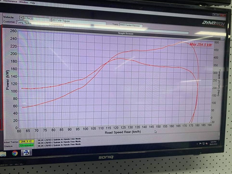

  • After a last minute spot opened up. My Tiguan is done. 254kw atw. Happy with the result.
    293kw was our best run but it was much too aggressive for a daily driver. Only driven it home and done 1, 2nd gear pull. I think the lag of an is38 makes it more pleasant to drove compare to stage 2 is20.
    I'll be sure to share some mpre feedback whem I've actually spent some more time with the car.

      Looking forward to your feedback. Also keen to see if you can get the overlay with the stock and stage 2 results for comparison with power/torque curves.

          Sweet... What boost for 254 and 290 runs? Got rpm vs power graph? Plugs / coils using? Installed a dogbone insert?

                Seems Tristan is too busy driving to reply but 254kW file was 27psi with peak at 28.
                The 291kw was a fair way north of 30psi... [emoji15]

                  • 27psi, IKH24 Plugs, Stock Coils, Dogbone Insert Installed.
