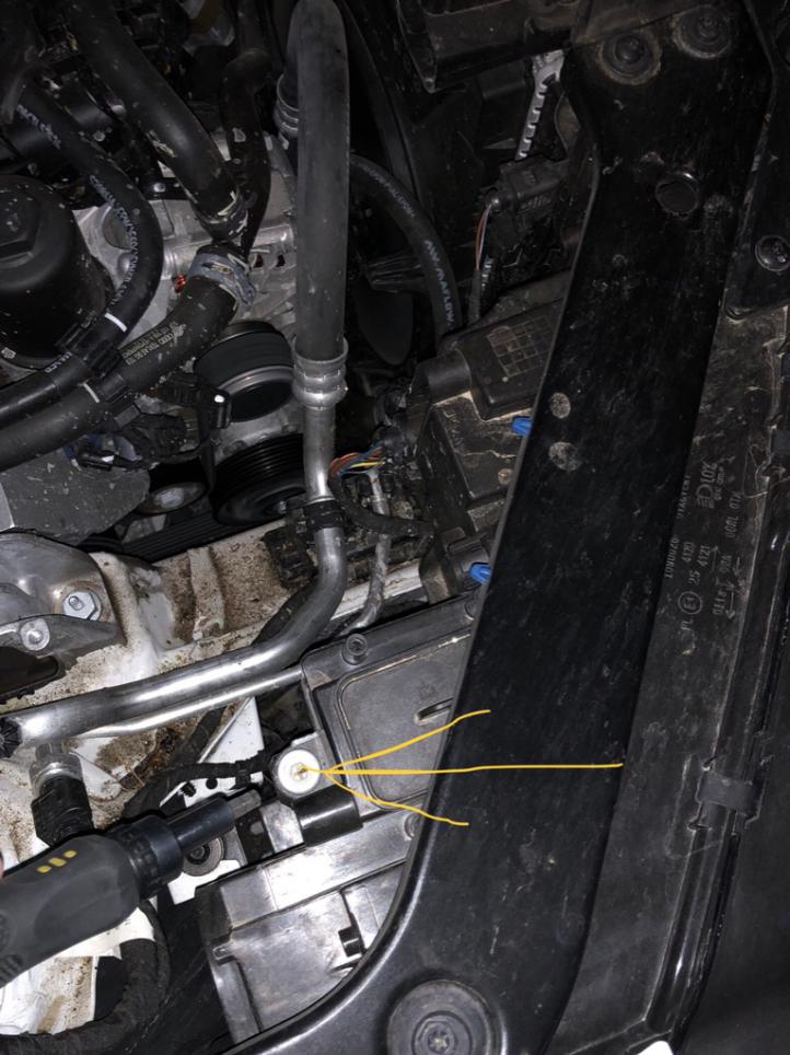

        I had mine adjusted at the dealer, I found the lighting too low, making it difficult to drive especially across mountain roads.
          You can adjust it using an allen key on the back of the headlight.
            Thank you, is there a video or instruction on how-to somewhere?

              How does one adjust the self leveling headlights with an Allen key?
                      Best to park 20m from a wall and make small changes. Don't over adjust as you'll blind everyone.

                          I'm not quoting official adjustment process, rather suggesting by parking a certain distance away from a wall you can work out if the headlights are being adjusted up/down. Really its making small changes and then ensuring it isn't extending past the leading edge of the hood of oncoming sedans in the distance, that way you shouldn't be blinding anyone.
                          My car (from new) would only illuminate 35-40m in front of me at night time on a country road which meant I couldn't really travel any faster than 40-50km/hr safely. After some small adjustments I can see down the road safely at speed without blinding other drivers.
