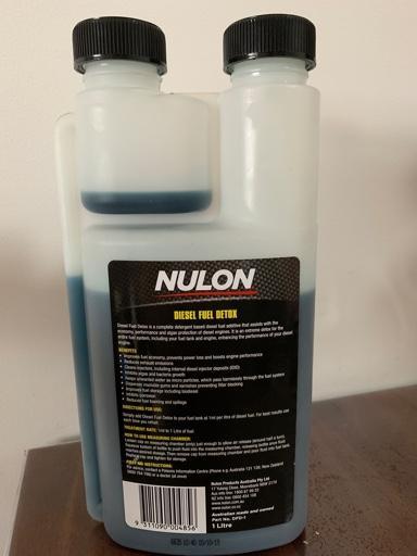

                  The V6 TDI wants to regenerate bit more often approximately every 300km and does throw out the DPF light with message “DPF See Owner’s Manual” after which I recommend you don’t turn the engine off. Just drive in S mode somewhere with less traffic lights until the DPF light turns off.
                  Using good fuel additive (like Nulon Diesel Fuel Detox) 100% of time will help to reduce the soot particles and significantly shorten time needed for regeneration. I also use Penrite DPF Cleaner every 3,000km.
