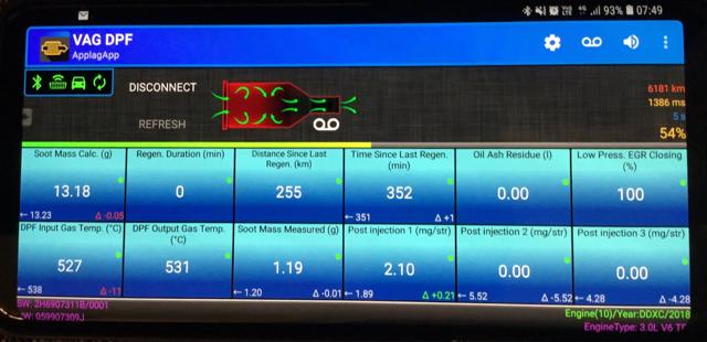

          I have recently bought a scanner tool to try and diagnose the problem myself. Here is what I have found:
          • The DPF active regeneration is triggered by the value ‘soot mass calculated’. This value is made up of the ‘soot mass measured’ and presumably other measurements like mass flow and temperature. When the ‘soot mass measured’ is more than 10g away from ‘soot mass calculated’ the latter jumps up to the ‘measured’ level ignoring all other calculation factors. Normally ‘soot mass calculated’ jumps to a level where active regeneration is triggered. However when ‘soot mass calculated’ is near the active regeneration level I suspect ‘soot mass calculated’ jumps through the active regeneration level straight into limp mode.
          • The DFP filter light comes on for a couple of seconds (if at all), before going straight into limp mode.
          • The active regeneration is very efficient. Doesn’t matter if you are idling, or driving on the freeway, soot mass is reduced. Driving faster does reduce soot mass quicker, although regardless of car driving profile DPF soot is reduced successfully.
          • Our Amarok never gets hot enough to passively regenerate. Soot mass is always accumulated regardless of driving profile. Highway driving or toddling around the suburbs requires active regeneration about every 250-300km.
          • Active regeneration occurs regardless of fuel tank level. I’ve seen active regens with less that ¼ tank of fuel. I’ve seen the car go straight to limp mode with a near full tank of fuel.
          VW say that driving profile and fuel tank level are the problem, but from what I have witnessed this simply isn’t true. Just shows you they don’t even know their own cars, and are not even attempting to fix the problem, just pushing it back on the consumer.

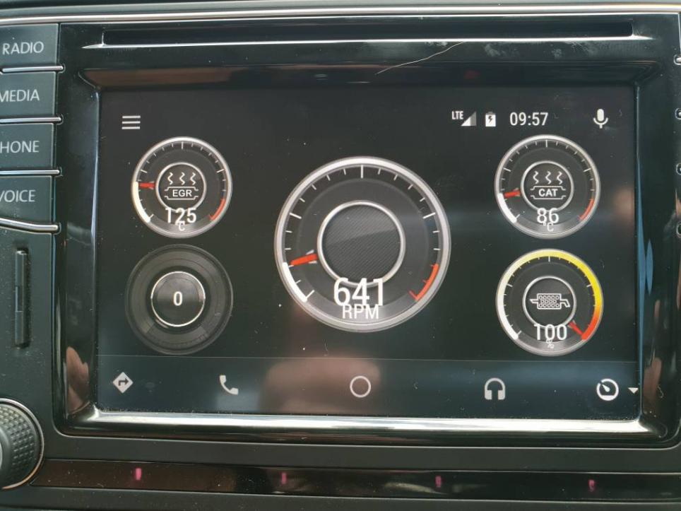

            • #51
              Does anyone know what android app and OBD module works with the Amaroks so I can bring the details up on Android auto like Jeromeos photo of the app that he was using?

                • #53
                  This is the info he provided
                  Originally posted by jeromeo View Post
                  The last screen shot is using torque and custom Pids.
                  But VAG DPF definitely works, you have to use engine 10.
                  B9 Audi SQ5
                  • #54
                    You need a little program called OBD2AA to use with Android auto.
                    But its not really straightforward to use.
                    Little bit buggy doesn't always start at first go.
                    Sent from my SM-G965F using Tapatalk

                          • #58
                            VAGDPF is handy for seeing what the DPF pressure/temperature/soot level is, but it doesnt allow you to do anything about it. I use to use VAGDPF religiously until Carista did a big update and now you can actually trigger a regen using the app. Since I now have this functionality with Carista I no longer use VAGDPF.
                            Note Carista shows you the soot level and has an option to trigger a regen - that is all. It does not show you DPF temperatures etc.
