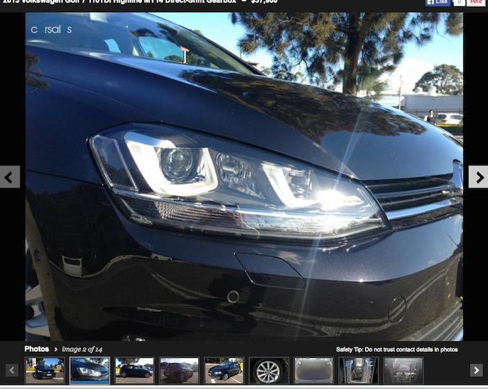

Here we go again - Xenons with second U

I have watched with a lot of interest the talk on if the second Inner U on Xenons can be turned on like a golf R, I had given up then on car sales I find a dealer car that has Xenons with a second U, it is a dealer car so I don't think a dealer has swapped Golf R headlights ..
Or was it a factory mistake ..

It is on check the other picsOriginally posted by Jimi View PostI'm not sure the inner U in that picture is on. It could just be the ambient light

I posted this before somwhere, Golf7forums states that it's just an empty tube with no hardware inside. Only the R has additional lights.
GOLFMK7 - VW GTI MKVII Forum / VW Golf R Forum / VW Golf MKVII Forum - View Single Post - Golf R DRL's - is it possible
Most likely just the light reflection in the pics.Last edited by n0d3; 27-05-2014, 10:25 AM.Mk 7 GTI PP
