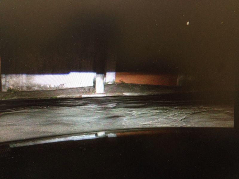

                            Light output for LHD V1s:
