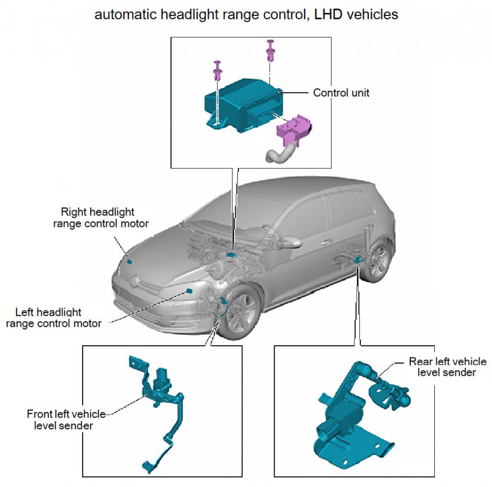

		Auto-Leveling Headlights complete set - Retrofit - VW Golf 7 - Bi-Xenon-39934_M
As for headlight washers, they are a separate unit you will have to install. This involves cutting holes in your front bumper. (Apparently there are guides etched into the bumper from factory), obviously you'd have to run the hose to your washer fluid tank. OEM HID equipped Golfs also have an additional sensor in the fluid tank to warn you of low fluid levels. So there is yet another part to consider.
As @Jimi has already mentioned, previous attempts to retrofit ADR compliant HIDs have run upwards of $3k.
