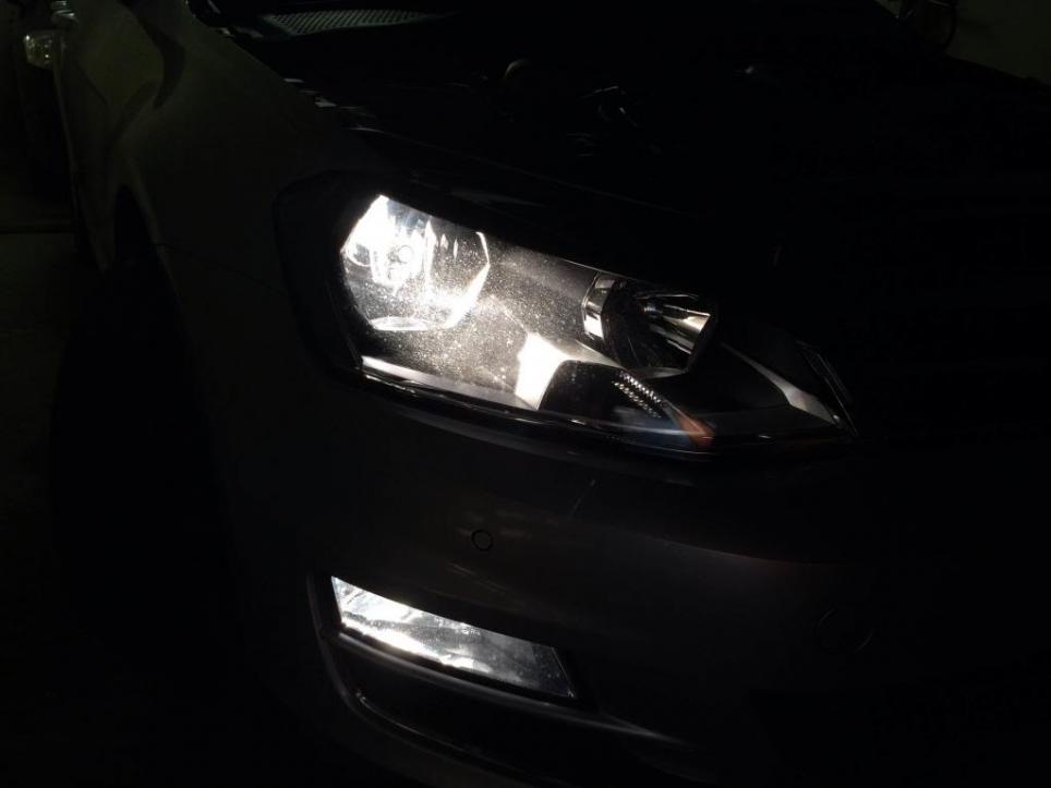

                        I ended up ordering Nightbreaker Unlimited for my H7/H11s and received them in the mail today! I'll get around to putting up some photos before and after. Was tempted to go for Phillips Diamond Vision but decided against it because they're not legal and don't theoretically have a significantly improved light output, they are reported to look more xenon like than the NBUs.
                        Have you received your kit yet Lucas_R?

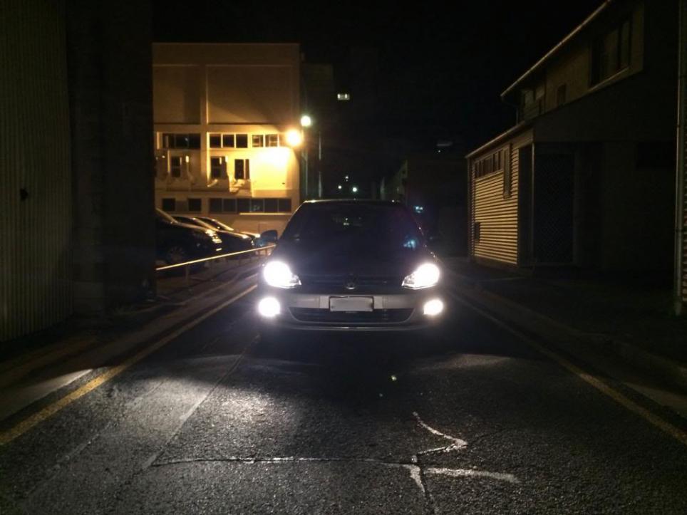

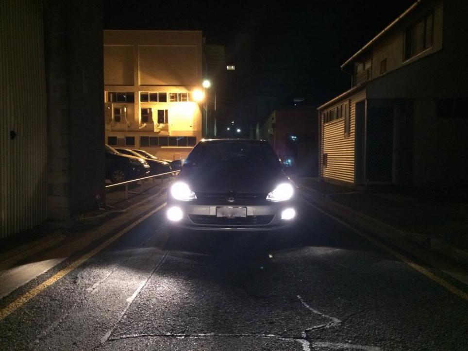

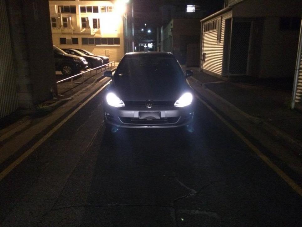

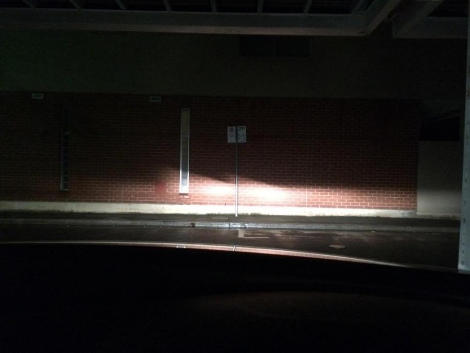

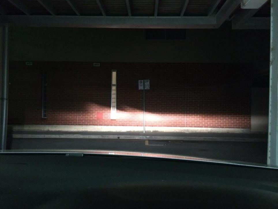

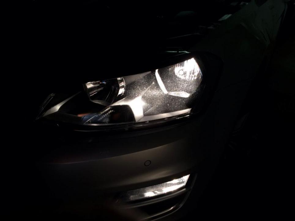

                        Ok so I've fitted the NBUs. They are slightly whiter than standard and appears to be brighter but unfortunately the photos don't show it that well. Whilst driving around the block to get these photos I definitely noticed the fog lamps lighting up corners better when turning into the street. I haven't had a chance to drive in the hills yet to see how much of a difference they make with little street lighting but I suspect it will provide more of an improvement in those conditions.
                        So the following will be a series of standard, half (standard passenger side/NBU driver side) and full NBUs unless stated otherwise.
                        standard:
                        NBU:

                          Thank goodness that Mk 7 is a definite improvement---------still ordinary though.

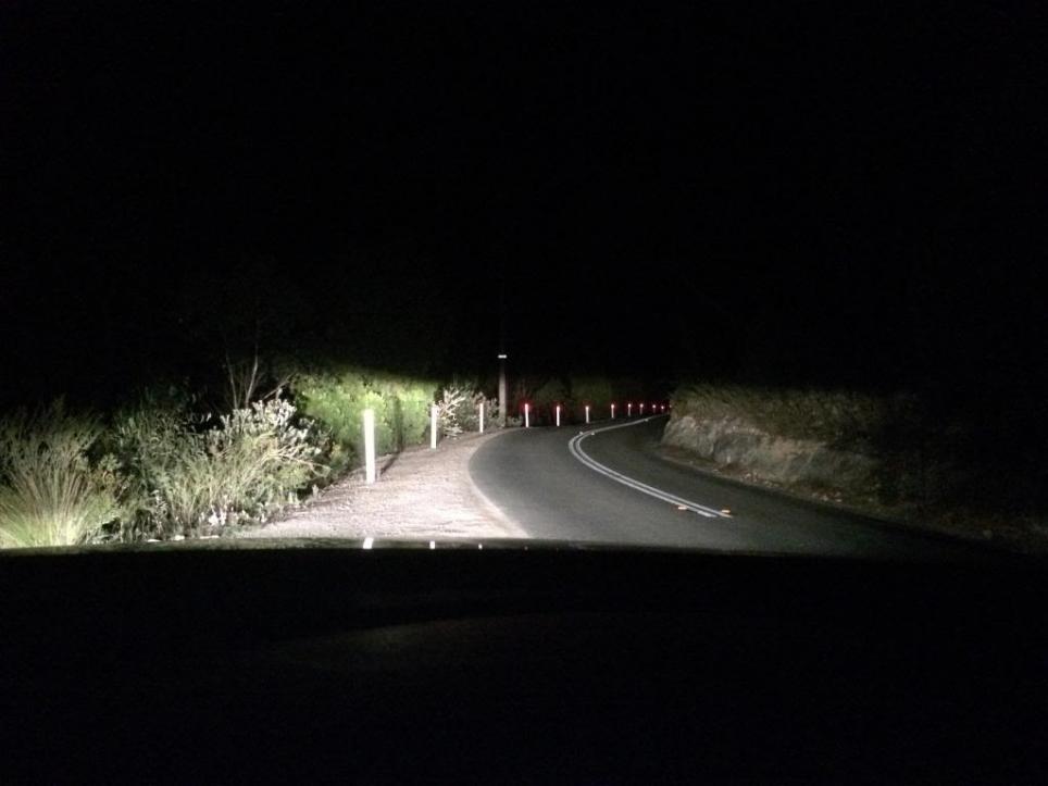

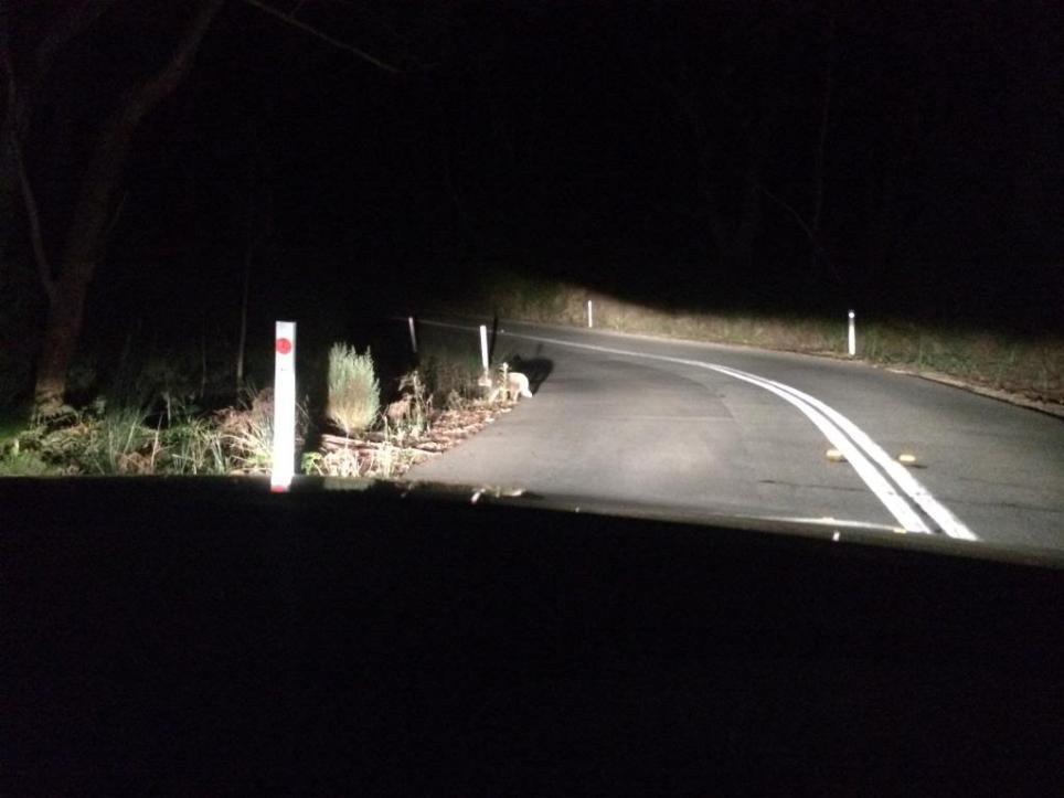

                            I've had a chance to take the car for a spin in the hills at night, it was definitely more confidence inspiring than the last few times with the standard lights.
                            I didn't take any photos of what they were like before but FWIW this is a shot with the NBUs. I couldn't find a spot to park on the side of the road where the road extended right out in front of me for a considerable distance.
                            I came around one of the corners to see this little critter.

                              How was installation veew?
                              Are the hills shots on normal or high beam? May consider this option depending on how I feel the halogens perform.

                                Ahhhh looking at upgrades even before you've taken delivery
                                I told you that you wouldn't be able to keep it stock.
                                Though those bulbs definitely look to be an improvement over the standard halogens.
                                The only benefit of a yellower light is that it generally performs better on fog.
