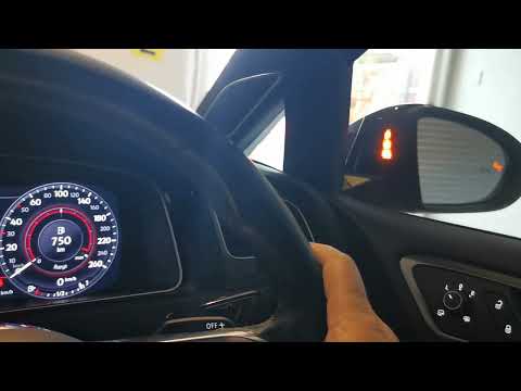

    Just wanted to post my recent upgrade.
    After moving from a Tiguan to a Golf I was missing the blind Spot indicator that is located on the inner side of the frame.
    Very easy to see and notice when a car is in your blind spot. (atleast for me)
    The Golf has the blind spot indicator light located on the actual mirror like most other cars. (as you all know)
    After watching the upgrade retro fit instructions on youtube I decided that was exactly what I wanted.
    However as I am not good with a soldering iron and cutting tool I decided to buy the mirror case with the blind spot indicator already fitted. (just like a Tiguan)
    The case comes in silver and also glossy black. (some type of not so expensive plastic)
    All I had to do was decide if I wanted the disable to original indicator on the mirror or not.
    I decided to keep the original also.
    Here is what it looks like now
    SHaring as I believe it may be useful to others.
    Regards

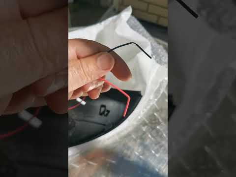

            I also replaced the stock indicator with a sequential type a few days ago before I performed this mod in order to get some experience taking off the cap. I also found that by lowering the mirror all the way down then using a knife to push/bend downwards the 2 clips holding the cap it would pop out easier. But as the wiring for the blind spot indicator is not visible from behind I had to remove the mirror to access it. The most delicate part of the job was removing the mirror without breaking it. (I used a suction cup to pull and a plastic tool to push from behind).
              As I ordered another set of side mirror covers (with blind spot indicators) for a family member I wanted to add a photo of the actual item as it is before installing. I believe they only come in Silver and glossy Black.
              The blind spot indicator is nicely fitted as can be seen in video.
