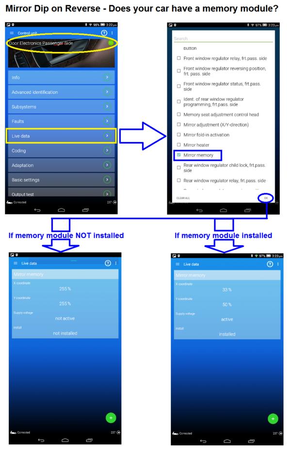

                Lucas: Hi. Regardless which diagnostic device is used, in my experience the most important decider as to whether mirror-dip will (or will not) work as a tweak is the factory installed equipment!
                Mirror-dip function needs to have some way of remembering the co-ordinates of the start position- so that the mirror can correctly return when the car moves in the forward direction. In cars that have factory enabled mirror-dip, the fittings contain a memory module for this purpose. However, in cars where this function isn't factory programmed - the memory module is often (but not always) missing!
                It's easy to confirm whether the memory module is installed - but the process varies with the type of diagnostic device used! If the memory facility is missing, the tweak won't work - or, if the tweak does work the mirror won't return to its original position (passenger mirror always needs to be re-adjusted)

                        Originally posted by FarQ View Post
                        i have obd11, so what would i need to check?
                        Just follow the instructions below (unfortunately the pictures use the old version of OBD11- but pretty-much the same information applies to the current release SW):
                        If your car has the memory module, the X/Y Coordinate values may be different than shown (this depends on your personal adjustment settings) - but the values can't be 255 %
