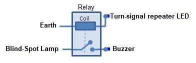

              notaGolfR: It's certainly doable- IMO.
              However, I think you meant "in parallel", rather than "in series" - the irony is that if you connect the buzzer in series, you will further reduce the lamp illumination because of the internal impedance of the buzzer - IMO
              Also, you might want to consider adding a variable resistor (in series) with the buzzer as a volume control - the constant sound might be a tad annoying!!
              The other embellishment that you might consider is to feed the buzzer through a simple single-pole relay which is wired-up as an AND-gate with inputs being the blind-spot warning lamp and the the turn-signal repeater LED like this:
              In this design, the buzzer only sounds if you have indicated a turn AND there is a car in your blind-spot - much more discriminating and therefore more effective as a warning device - IMO.
              Anyhow, please let us know how it works-out, if you proceed
              Don

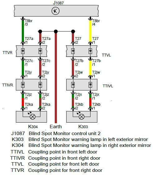

              PS: I made-up the schematic diagram below from the wiring diagram for a mk7.5 NAR model Golf. I suspect that RoW mk7s will be fairly similar - hope it helps. You might be able to pick-up the warning lamp signal from one of the "coupling points" in the door

                Thanks DV52. I appreciate all your effort. As is my custom, I will certainly let you and the forum know my experience if I proceed.
