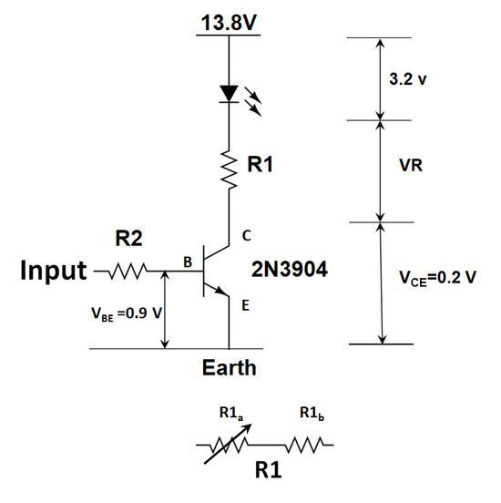

A very helpful poster “Don” suggested to me to incorporate the simple circuit below to avoid any possibility of messing the can-bus although he says, relying on the VW circuit diagram, there are no CAN messages that will go through the mod. The most important reason for it is it provides a degree of electrical isolation between the driver circuits inside the oe system and the load from the new LEDs. My layman explanation of the circuit is that the input is connected to a wire that sends the signal to the o.e. Lamps in the exterior mirrors. That signal goes to the base of the transistor which allows connection between the collector and emitter and hence power to the added LED. R1 is a variable resistor to allow you to “trim” the brightness.
“Don” kindly calculated the values of the components to suit the LEDs I chose.
R1 is 347 ohms , made up of a a fixed resistor of 300 ohms and a Spectrol 25 x Turn Trimpot of 100 ohms.
R2 is 20 K ohms
The transistor is a 2N3904
I THINK the LED is White 5mm Cree LED 45000mcd Round Clear Jaycar CAT.NO:ZD0290. I think these are correct but as I destroyed LEDs along the way and cannot confirm the replacements, you should calculate your own values to suit.
Here is Don's information, but substitute your own figures for the specs of the variable resistor and LEDs you choose
" To calculate R1 - we need to calculate VR in the diagram like this:
VR = 13.8 - (3.2 +0.2) Volts = 10.4 Volts
R1 =Volts/Amps = VR/(LED nominal current, 30 mA) = 10.4/0.03 = 347 ohms
To choose the power rating of R1: Watts= V x I =10.4 x 0.03 = 0.3 Watts
R1=347 ohms
To calculate R2 - I need to introduce the concept of DC Current Gain (called "hfe"). You can think of this as the transistor "amplification factor" when switched-ON. Or said another way, it's the amount of transistor Base current (let's call this "Ib") needed to make the required current flow through the Collector/Emitter junction ( let's call this "Ic" - which is 30mA in this case)
By definition hfe= Ic/Ib. Or Ib = hfe/Ic
If you look at the spec sheet, you will find that the minimum hfe when the Collector/Emitter current=50mA is 60. Let's use hfe=60 since 50mA is close to our circuit current of 30 mA.
So, this means that Ib needs to be 30 mA/60 = 0.5mA
Now, assuming that the nominal voltage of Input in my diagram= 12V, the voltage across R2 = 12-0.9 = 11.1 Volts. And since we need Ib to be 0.5 mA, R2 = V/I =11.1V/0.5mA = 22.2K. For the sake of reliability, let's choose 20 K ohms
R2 = 20 K ohms"

This circuit is buried in here somewhere and is duplicated in the same cavity on the other side of the dash. It enables a blindspot LED in front of the driver.
A figure 8 wire is connected inside the external mirror to the + wire of the oe BS lamp. It then goes through the mirror, out through a mirror bolt hole then to the circuit at Input. The other half of the figure 8 comes from the – wire of the oe lamp then to the Earth. The oe BS lamp operates as well.
If the BS monitor device in the rear bumper tells the oe lamp to turn on, the signal in the mirror also goes to the “base” of the transistor which allows C and E to pass electrons and the cabin BS LED lights up.
The +13.8V and comes from a 12V cigarette lighter plug in the cubby in front of the gear selector and goes to the long leg of the LED and the the short leg to R1. The – of the plug goes to the E of the transistor.
R1 is a variable resistor is a Spectrol 25 turn 0-100 ohm trimpot (to trim” the cabin LED to suitable brightness) with a fixed 300 ohm resistor which ensures the LED does not burn out. R2 equals 20K ohms. The cabin LED is a ZD0196 5mm clear white 33000MCD
