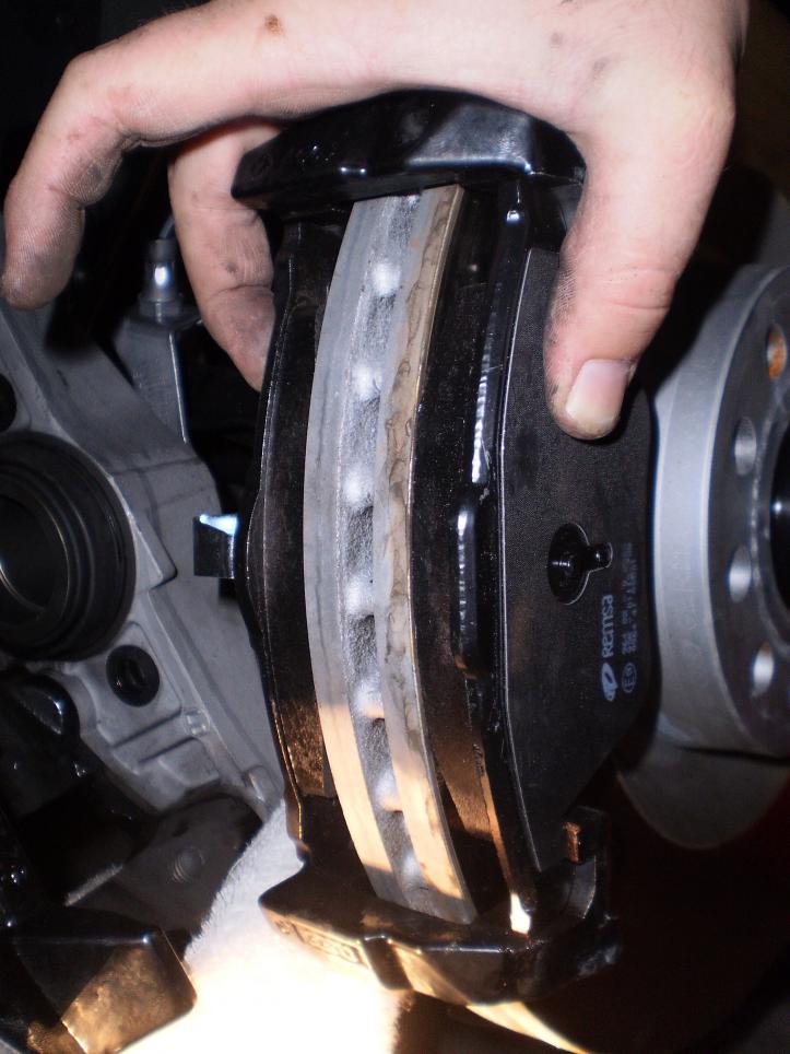

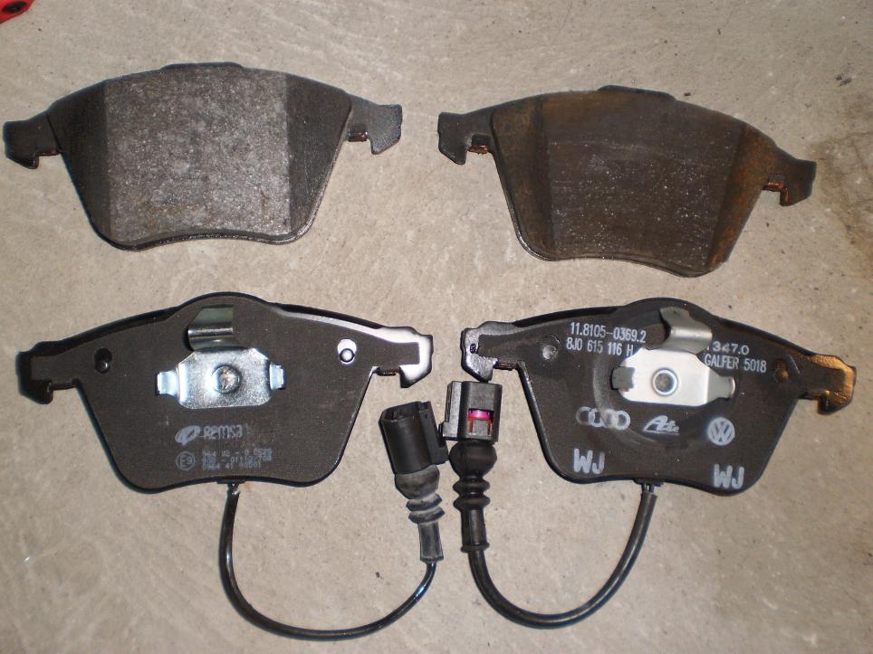

                          Image of front pads: Stock VW ones on the right, new Remsa pads on the left. Note the plug is for the low brake pad warning sensor and is fitted to the passenger side of the vehicle.
                          Step 1) Once you have the wheels off, on the rear of the caliper there are 2 plastic caps that need to be removed to gain access to allen key bolts. Using a 7mm allen key, loosen the allen key bolts and remove them - this will allow you to separate the caliper and gain access to the pads.

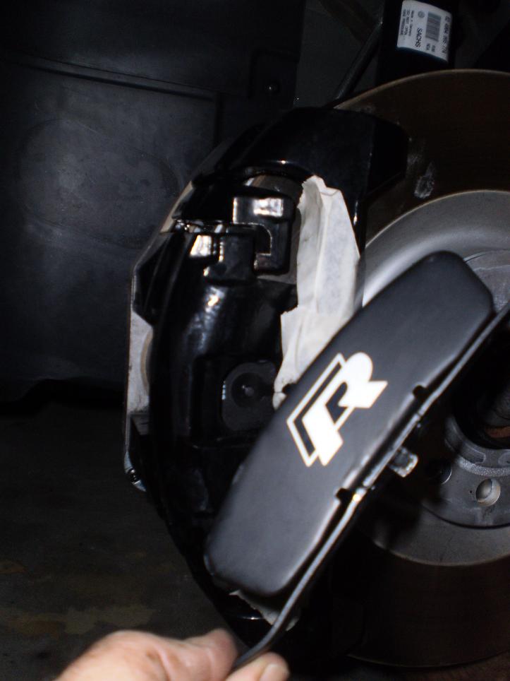

                          Step 2) You will also need to remove the spring on the face of the caliper (the part with the R logo on it). In order to protect the paint on my calipers, i chose to put some masking tape over the areas at risk of being scratched. Insert a flathead screwdriver at each end of the spring arms to lever the spring arms away from the caliper slightly. Once you have done this, several decent tugs on the spring (towards the centre) will have it pop off. Just keep a good hold of it because it has some spring-iness in it and will fly off if you aren’t holding onto it.

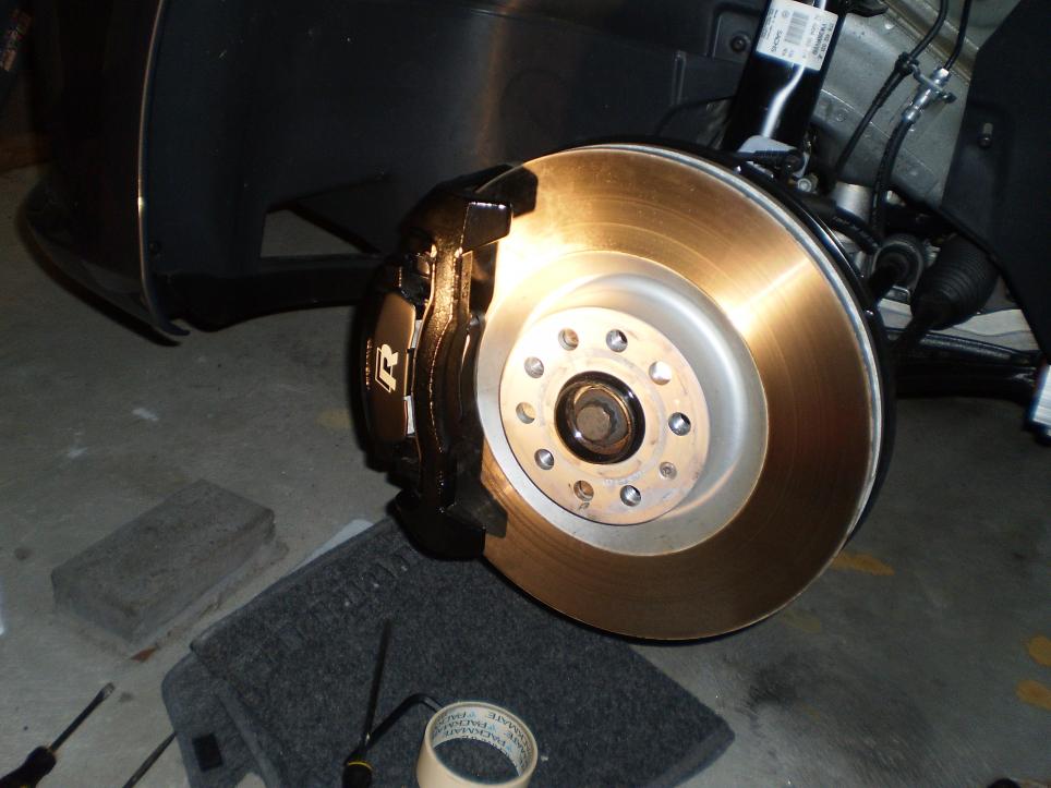

                          Step 3) Once you have removed the 2x allen key bolts from the rear of the caliper and removed the R spring on the face of the caliper, you will now be able to wiggle the caliper off. I would suggest getting something (piece of wood/box etc) about 20cm high to rest the caliper while you change the pads, to avoid stretching the brake lines.
                          Step 4) Now if you have travelled some kilometres in your R, you will need to use a brake piston compressor to push the piston back inside the caliper unit before fitting the new pads. Because my R had only 400kms on it when i did the pad change, this step wasn’t necessary for me.

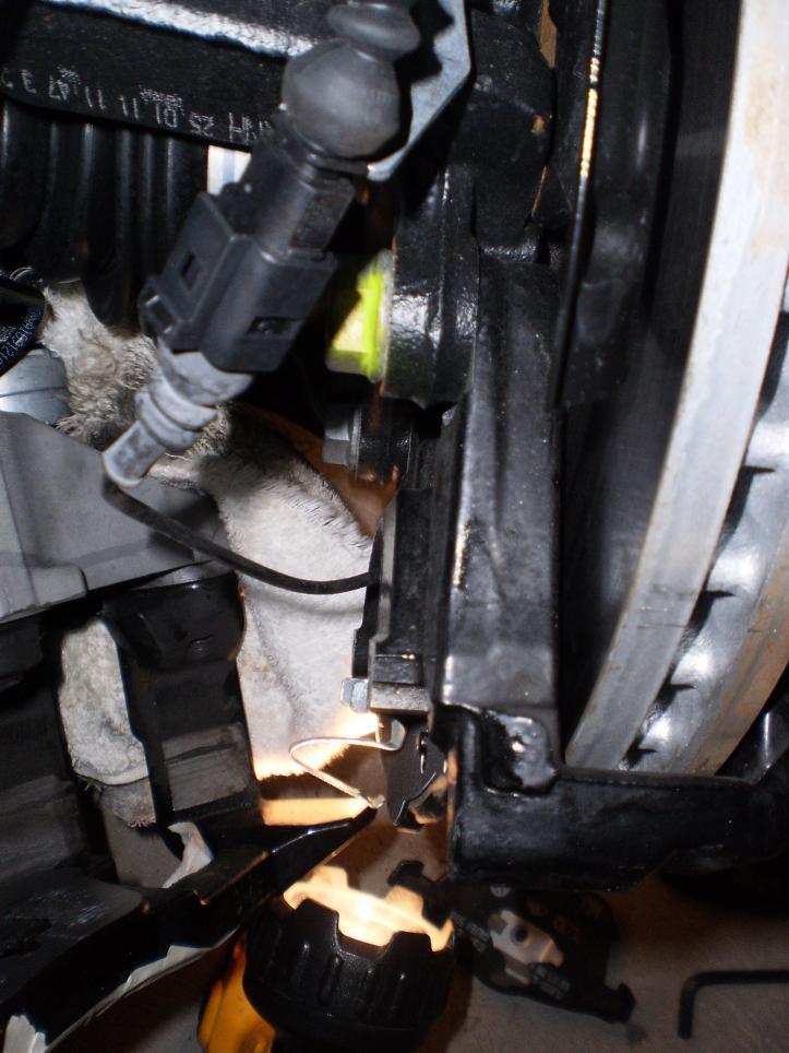

 Remove the old pads, and replace them with the new pads. Note that the passenger side brake pad features a low pad sensor (as shown in the 2nd image below).

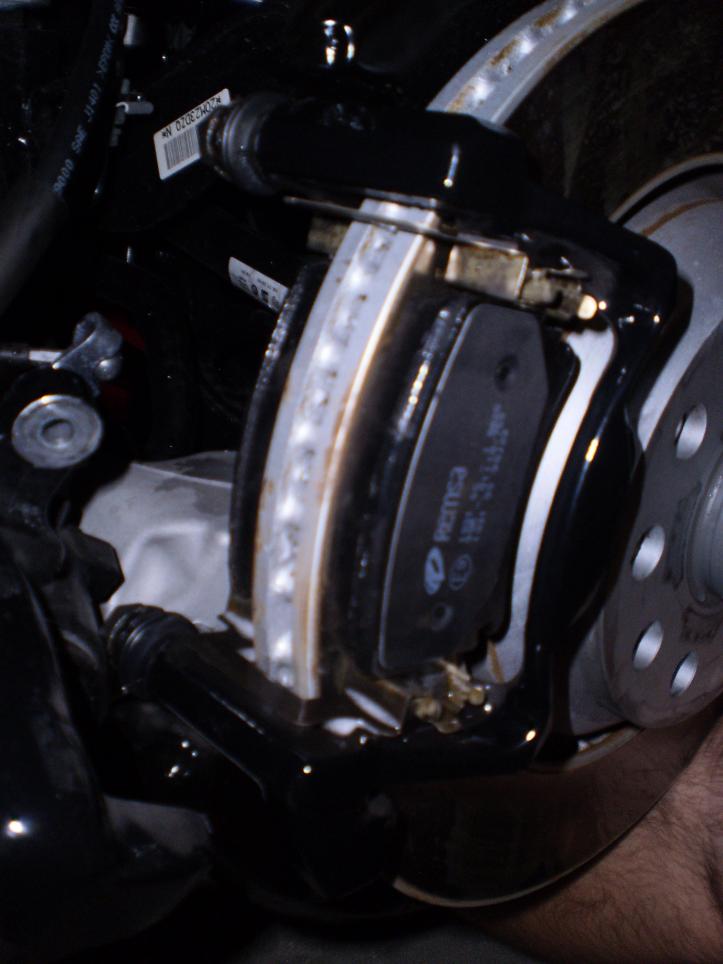

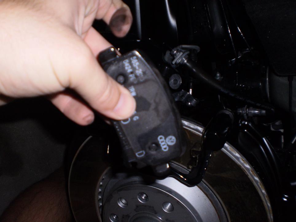

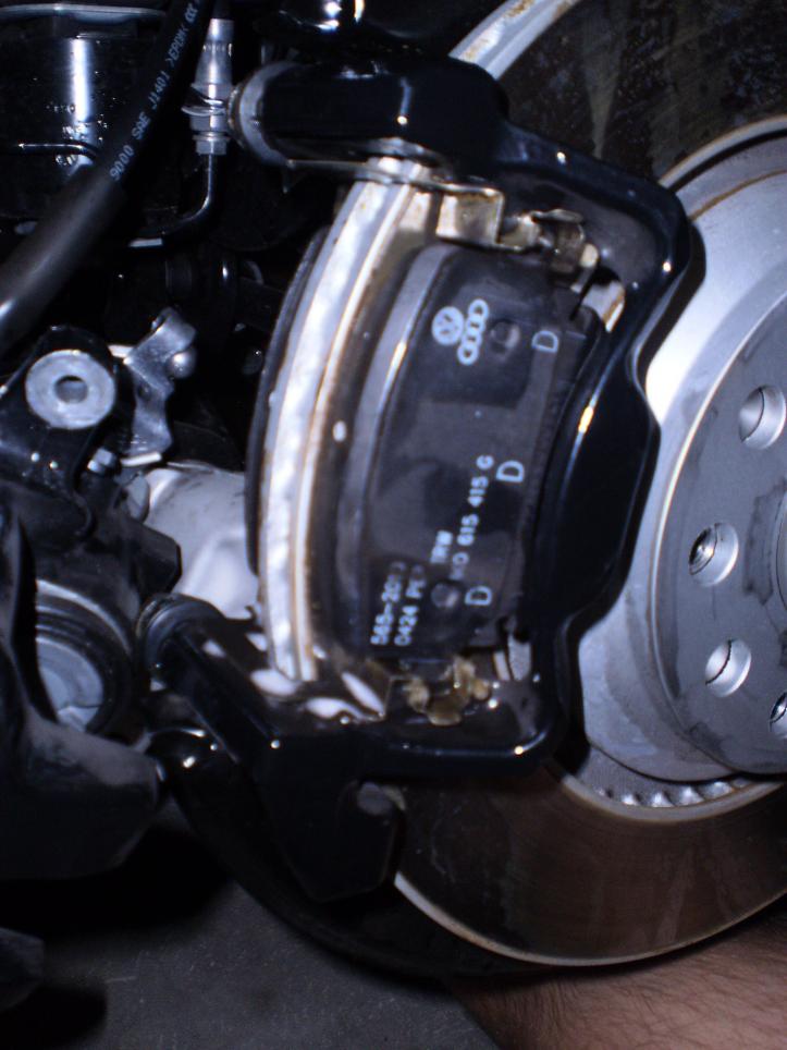

                            Image of the standard pads with the new Remsa pads.(new pads on the top, stock pads on the bottom)

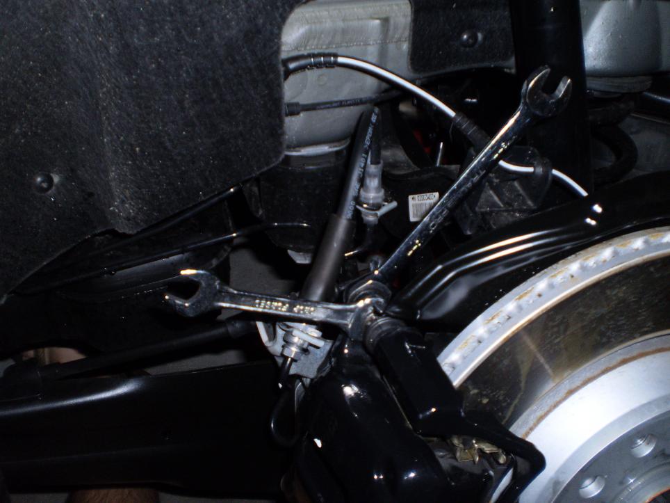

                            Step 1) Once you have the wheel off, locate the two bolts on the rear of the brake caliper which secure the two parts of the caliper together. You will need a 13mm open ended spanner to undo the bolts while simultaneously using a 15mm spanner to prevent the bolt from spinning (hard to explain but see the 2nd image below)
                            Step 2) Once you have the two bolts undone, remove them from the body of the calliper. You should now be able to wiggle centre part of the caliper off and gain access to the brake pads.
                            Step 3) This is pretty much a common sense exercise now. Remove the stock pads from the caliper and replace them with the new pads. The pads sit in a specific area of the calliper so you’d be hard pressed to get it wrong here.

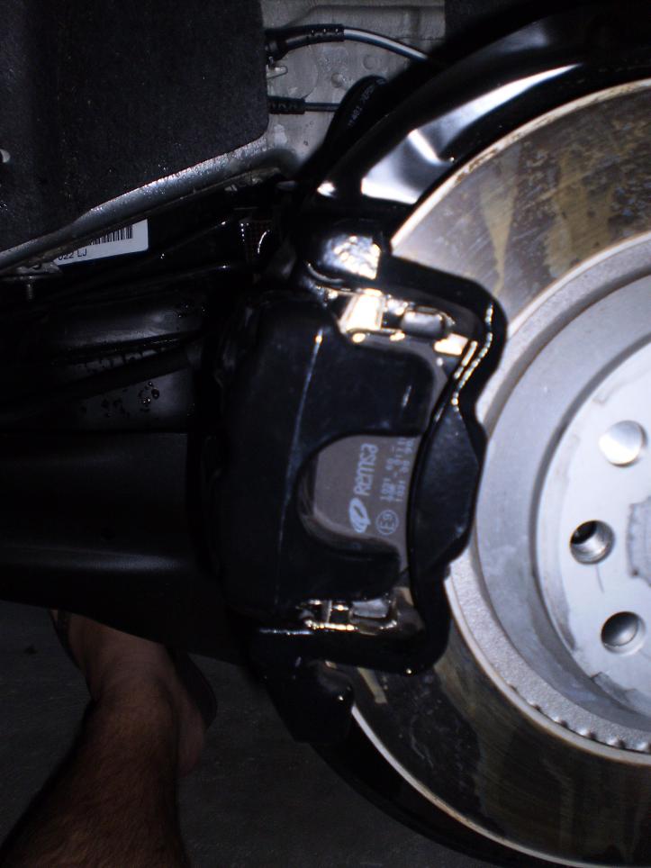

                            Step 4) Once the new pads have been put in place, re-fit the central caliper section over the top of the pads. Note, that you may need to use a caliper piston compressor to re-set the piston into the caliper at this stage.
                            Re-insert the 2 bolts that you removed in Step 1 and 2 and do them up tightly. It should now look like this.
                            Lastly, put your wheel back on and pump the brake pedal until you get a firm pedal feel, then take the car for a cautious drive and double check everything feels and works ok.
