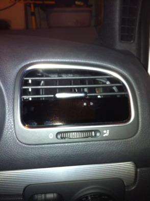

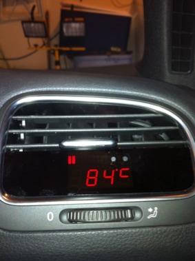

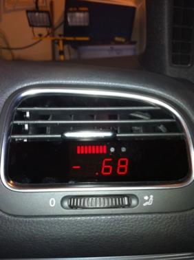

piccies pleaseOriginally posted by Candyman View PostP3 gauge installed, Too easy, took all of 15 minutes. Works well. Just need to figure out the dimmer connection but may not bother and just leave it in night mode.Current Ride: MY 16 Daytona Pearl Grey Audi S3- Performance Pack 1, Sunroof and Driver assist

Hey Candyman, good the see the gauge arrived! Looks great! Now I though the dimming function was automatic with the dashboard - but it's actually not. Wouldn't mind being able to see what it looks like dimmed (P3 advertise it on their website that its dimmable). Let me know if you figure it out!MY18 MKII Tiguan 162TSI R-Line | Deep Black | DAP | Sunroof

Requires you to splice the long green wire into position ten (grey) on headlight switch
Instructions on P3's FB page
I'm not going to bother
You can dim it using the right button (need to do it whenever you start the car)
Rick said next software update will have an option to remember the setting.8VSS2L/16 E9E9 XG MP SPP1 4ZD 6XK CSC5P with an extra free 10kW
