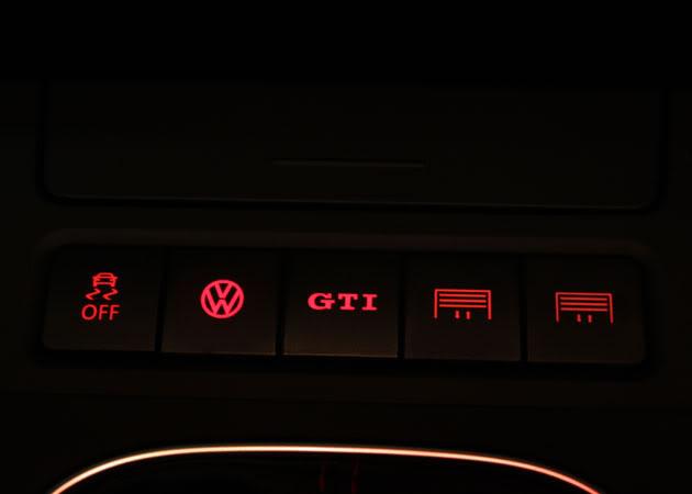

        • Installed the Garage Door pushbutton mod yesterday.
          A simple but very handy modification.

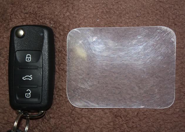

          The hardest part was removing the gear shift surround. I cut a section out of a Chinese takeaway container lid and slid it into the gap between the two plastic assemblies. Then it's simply a matter of carefully lifting the surround up and out.
          The buttons and covers are available here.
          The mechanics of the mod are explained here.
          Power for the LED's comes from the Electronic Stability Program (ESP) button connection.
          Just piggyback the buttons and covers off this connection.
          This piece of Chinese takeaway container lid was used to remove the gear shift surround without damaging any plastic parts..

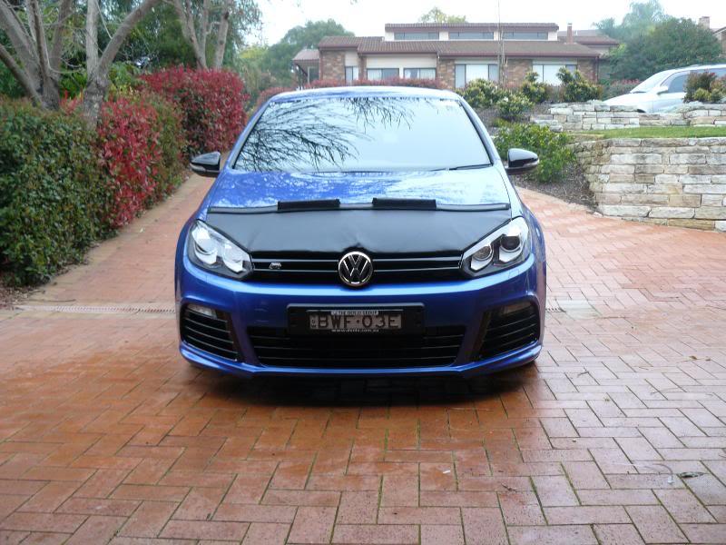

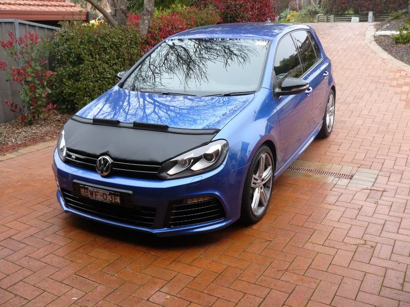

            • Ordered a car bra from Turkey.. love it.. for those that are wrap fans look away.. also the tint just went on but that is no biggie
              • Watch out for rubbing on the paint mate
                Most of these car bras cause damage over time.
                • Only got it for my distance runs up the coast not as a daily use.

                        Now out with the stirring and in with serious. Is it a quick fit/removal bra? And I'm curious about the triangle shaped strips. Are they wind deflectors?

                        • lol... so why do that instead of putting PPF on the bonnet? Considering how little that car bra protects, the equiv fitment of PPF would be rather cheap, and eleventy times less ugly than that (in fact, it would be completely invisible at the distance you took those photos)

                            Yep takes about 5 mins and has some straps underneath that secure it but it is a snug fit. The triangles are ther I guess to hold it down so it wont flap at speed. Took it for a run this morning and no movement at all very happy with it

                            1. this is not permanent and only for my occasional long runs up the coast
                            2. The PPF does not clean well, I love working with wax.. the PPF just is dead in my eyes
                            3. PPF is very expensive and I checked with Rob this morning when he was tinting my car he rekons it would be $200 easy for the coverage as it is so expensive and it collects dirt all along the edges.. he had it on his car.. not interested and this solution was $55 delivered.
                            4. It is not a visual enhancement but that is not it's purpose.. but corey as you have to be right about everything I guess it is ugly
