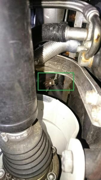

                        • Just buy the clip and install it yourself - thats what i did. it fixes 90% of the noise. Its a tight fit to get the clip on there, but can be done.
                          i'll have my car jacked up this wkend, so i can take a few photos of the clip if you need it.
                          PS - the treatment from the dealership is pretty typical of VW.....not their strongpoint.
                          EDIT - here is a pic of the wastegate clip installed on my Mk6 GTI. This is looking from under the car and the back of the engine.
