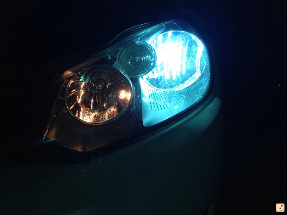

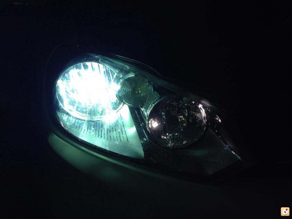

Oh, I thought you bought the proper HID kit as in headlight assembly, wiring loom, leveller etc. If just a globe replacement is a piece of piss to fit, just need to find somewhere to clip the ballast in safely, swap out globe, connect to loom, done (if not designed for "canbus" you may get globe out errors.

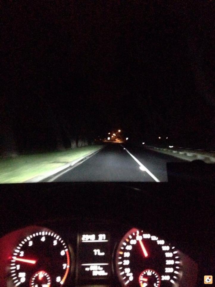

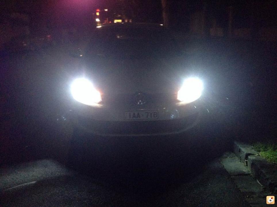

I had the Jaycar H4 ones (with the electromagnet low/high adjuster) in my WRX and the light cut off on low beam was very good (they came with holder that had shield built in, you could see a very good vertical demarcation), was never flashed by incoming cars once, unlike when I tried 80/100W cheapie H4 halogen that didn't go into the lens focus point properly and glared all over the place...
