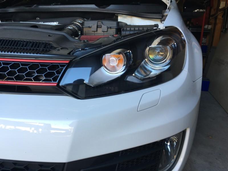

      I have been looking into this upgrade for quite some time - so im hoping that i made a good choice with these headlights. So far so good at this stage, although its only been about a month.
      B9 Audi SQ5
      • Was it a simple plug and play or had to buy other sensors and all?
        • Originally posted by Has View Post
          Its all plug and play. No additional parts needed. The only thing i had to do was a coding change with VCDS to tell the car i didn't have DRL's so that i didn't get an error on the dash for a faulty light bulb.

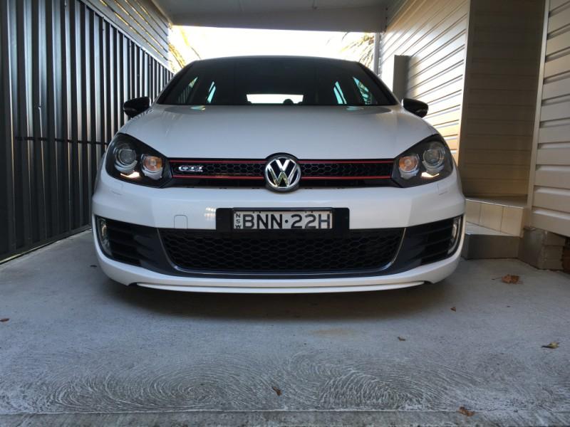

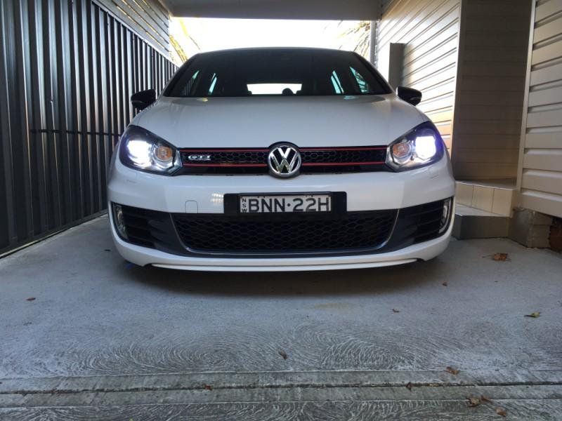

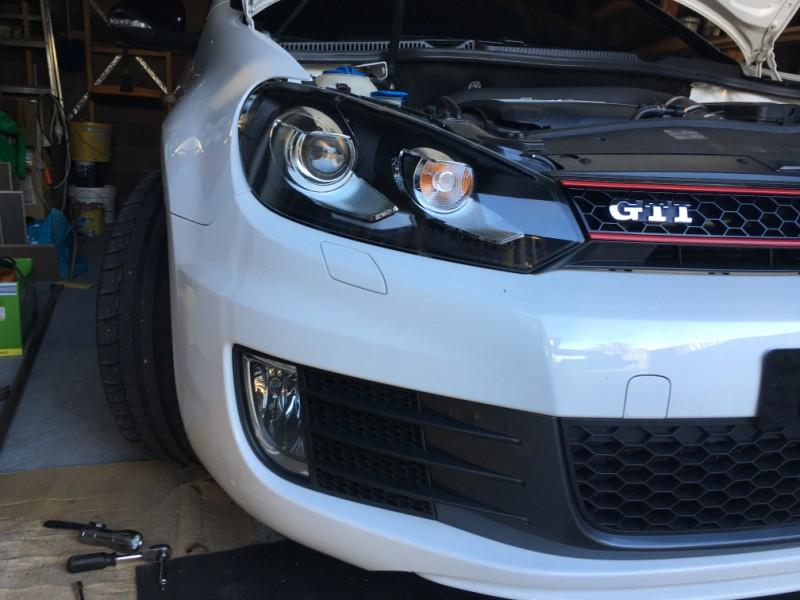

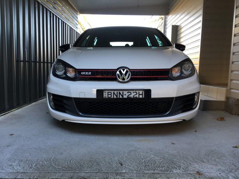

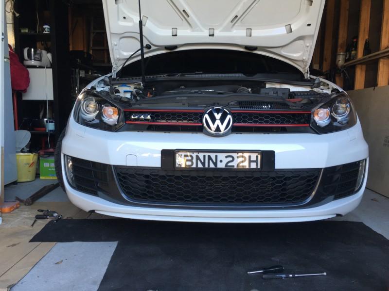

                  I've just done a halogen to Golf R style projector headlight swap on my 2010 GTI. Also used a good quality Morimoto 35w Canbus 5500k HID kit. I am very happy with the headlights overall.
                  My headlights are Eagle Eye brand and look exactly the same as the Golf R silver housings. I am extremely fussy, and have been looking into this upgrade for about 12 months - so i was pleasantly surprised to know that fitment was great, quality also looks great, plugs and wiring were concealed and neat, and the light output is much better than the factory halogens.
                  I have seen the Vacar branded lights in person and the quality never won me over - plus lots of people have issues with condensation and clear coat peeling. I purchased these through a Sydney based business on Facebook. VCDS Coding & Diagnostics Sydney is the Facebook page to look for if you are interested.

                    The headlights are bi-xenon, same as the factory setup - which means both low beam and high beam are in the single projector and within the projector there is a shutter than opens to allow more light to come out when hi beam is engaged.
                    As for levelling, you have a dial in the cabin which allows the light level to be adjusted up/down, and then the headlights themselves have a manual adjustment on them so you can get them aimed correctly.

                        Finally got a set of bixenons for my GTI, im trying to find somewhere that can carry out the installation for me in the Sydney area.... Does anyone know where i can take my car?
                        first things first, make sure you have the rest of the parts to ensure that the bixenons can work. such as uprated cecm with high beam shutter pins, leveler sensor, harnesses, etc etc.
                        this link should give more insights into what is actually involved (assuming the bixenons are genuine ones):
                        DIY - OEM Bixenon Headlights, CECM Upgrade and AFS

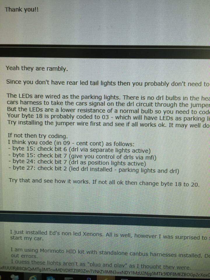

                          Hey Lucas_R what was the coding used? I've got the Chinese replicas with the DRL strip and can't get any coding... maybe yours might work for me
                          • Originally posted by TeamCrash View Post
                            This is the coding i followed and worked on my car.....only issue is that i cant remember which of the following options was the one that worked.
                            B9 Audi SQ5
                            • Originally posted by Lucas_R View Post
                              Thanks I'll give this a go. I've got the R tails so we'll see if it works too with them...
                              • Ok so today ICEWOLF had a go at trying to get the LED's running. We tried everything without much luck at all. We changed Byte 18 from 04 to 3B to confirm that all "lights" were working, but this gave the bulb out warning, and also meant that the brake lights stayed on. but yes the LED's/DRLs do work.
                                We followed all the links;
                                Product Review - Chinese Replica MK6 Golf HID Headlamps for halogen cars
                                VW Golf Mk6 Bixenon Upgrade - Album on Imgur
                                But could not get them on on any setting be it auto/parkers/manual.
                                On the way home I noticed some "lights" were on when I was stopped behind another car... I've pulled over to have a look. Great their on!!!! YAY a win... I think
                                Now here's the thing. This was on Auto lights, once I turned over to parkers and the manual lights - the "DRLs/parkers" were off. these are really faint compared to when we had them on under byte 14 3B. But also the headlights are on so its not really run lights.
