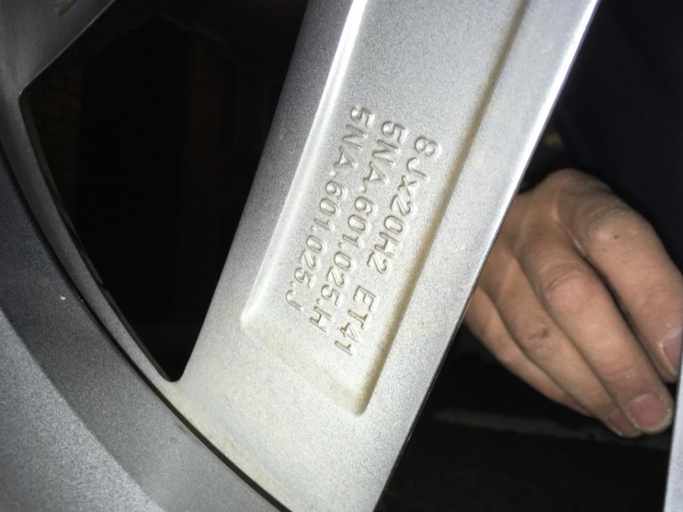

                  Back on topic yes most likely incorrect PCD on wheel. If it’s decent quality it should have the specs marked on the back face of the wheel.
