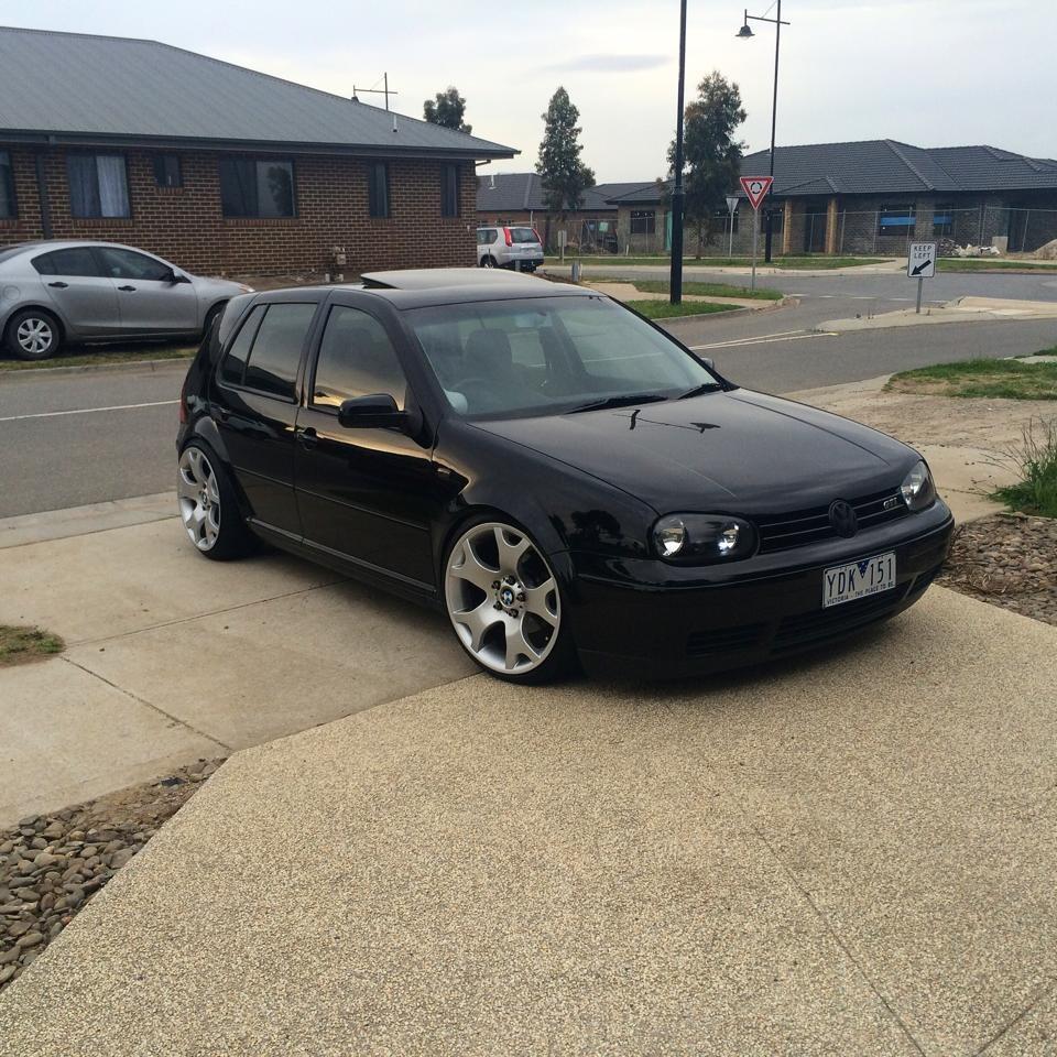

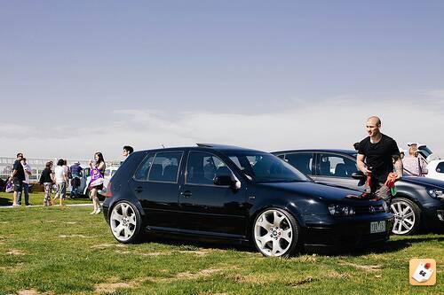

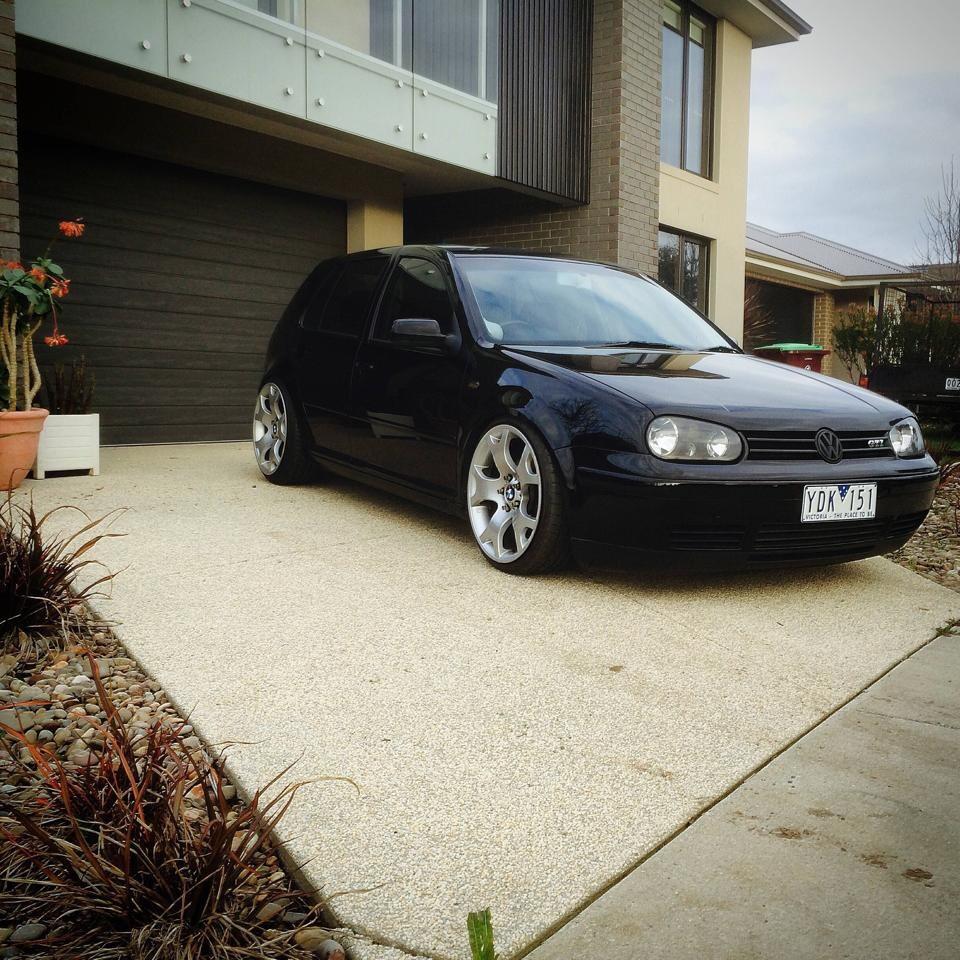

                            • VWW Official MKIV Wheel Q&A
                              Car: 2000 GTI
                              Wheels: BMW X5
                              Front: 19x9 et23 (after 25mm adapter) 225/35/19
                              Rear: 19x10 et25 (after 20mm adapter) 235/35/19
                              Fenders Rolled: yes (all four)
                              Fenders Pulled: 2mm in rear
                              Camber: Front -1 / Rear is standard
                              Suspension: Fk Ak street's with helper springs removed and Ground Control camber plates in front.
                              Notes: Car was lower but had to be raised 5-10mm all round due to rubbing and grinding all over the place.
